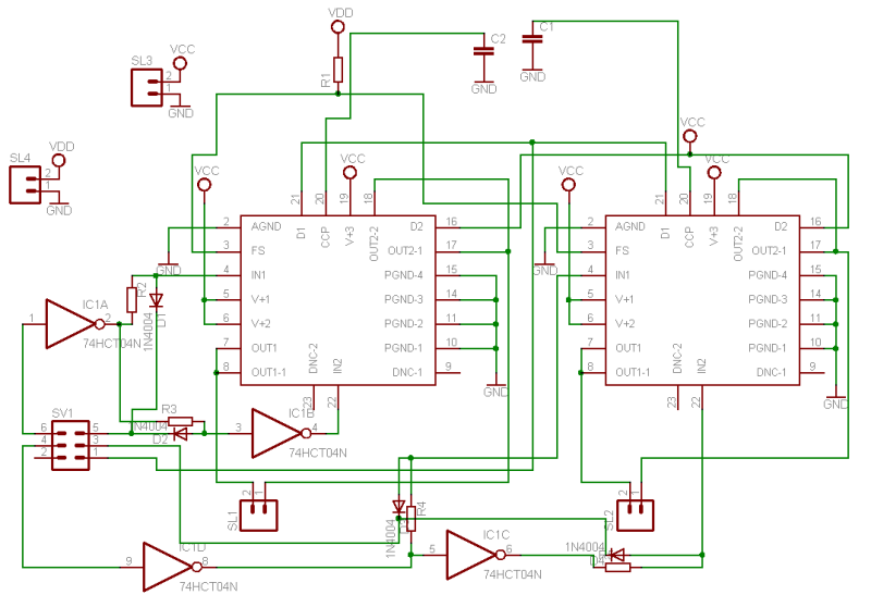

I want to run two cordless drill motors through MC33886DH-s with PIC16F876A. The MC33886DH uses two inputs to control the direction of the motors, but the PWM is applied to the pin, that is LOW at the time. So when running in one direction, I need to PWM on pin, when running in reverse - another. And since I want to run 2 motors, I'd need 4 PWM outs. Is there any other way to solve the problem, aside from getting a new pic?
but I need to PWM two pins alternately.
Say I use PinA and PinB for controlling one motor. So when moving forward, I'd keep PinA HIGH and PWM PinB. And for reverse I need to hold PinB HIGH and PWM PinA.

ok..I started wondering something... I would be set, if there was a way to switch I/O-s with an extra logic gates or something like that.
Or maybe with a couple of transistors? Create a low power H-bridge, use PIC PWM pin for one input, take +5V for the other and a second PIC pin to control the direction of the small H-bridge? That could work, couldn't it?

Someone recommended to use 74HCT00-s to toggle the PWM and the second PIC output. But I have no idea how to accomplish that... :oops:
Its simple look have two normal I/O pins drive the H brihgt trough a resistor. Then have an diode to the PWM pin.So the at the PWM signal will pull down the I/O pin.So you make the I/O go high an the PWM will pul it down trough the diode.
This is the simplese way to drive an H bridge whith no enable fuction.
An more profesional method would be AND gates.
Heres an schem

ok, so this should work?
SL1 and SL2 - motor outs
SL3 - motor and H-bridge power
SL4 - +5V power
SV1 - to PIC
