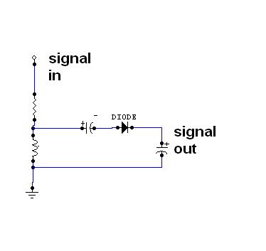

i got a Tx and Rx that i removed from my radio controlled car and i seperated them from the decoder and the encoder in order to place my own.
My question is: How do i remove the white noise in order to get a clear zero or a clear one, just so that a PIC could decode the signal.
Peak to Peak, the signal is at 1.5V
And what sort amplification should i add?
How should i modify the signal in order for the PIC to differenciate between a one and a zero???

note the company that made them and their model numbers, search for datasheets
as these datasheets speak a lot. generally Rx can work at -100 dbm input signal. so it is not noise alone. you may get these datasheets or near by ones at
https://www.rentron.com/PicBasic/RemoteControl.htm
it's a cheap chinese toy, i found datasheets for the decoder and the encoder which i intend to replace. No details about the quality of the signal is mentionned in the datasheets plus they're in chinese :S
i was thinking of sending a high freq signal (when one) and connect the receiver to a resistor-inductor circuit (high-freq pass) and then, send the treated signal through a capacitor removing the DC current , after that a diode will keep one polarity and this final signal will be set in parallel with a capacitor in order to get a continuous one.
When i'm sending nothing, the RL circuit is stopping the noise from penetrating thus a clear zero.
Would it work?? and what about the values, i'm a total newb when it comes to values

You certainly don't need a filter, which would be completely useless - if the signal level isn't high enough, then a simply transistor amplifer/inverter is all that's required.
However, I suspect the problem is probably with your PIC program, you DO need encoding and decoding - what is it currently doing?.
i tried using an inverter and right now things are working ok
thanks guys :D
btw, i haven't connected my pic yet, i was just comparing noise to a standard unmodified toy transmitter

Does your PIC program include a software PLL, to exclude noise? In the manner of a cassette tape interface i.e. as done in the ZX Spectrum 'TapeLoader'? I suspect that Nigel's PIC has.
The way that 80's cordless telephones did it in the hardware instead of in software was by transmitting a 6 kHz tone that was AM modulated by the encoder IC output, and at the receiving end, the 6 kHz tone + radio noise was AM demodulated into a pulse train again.
