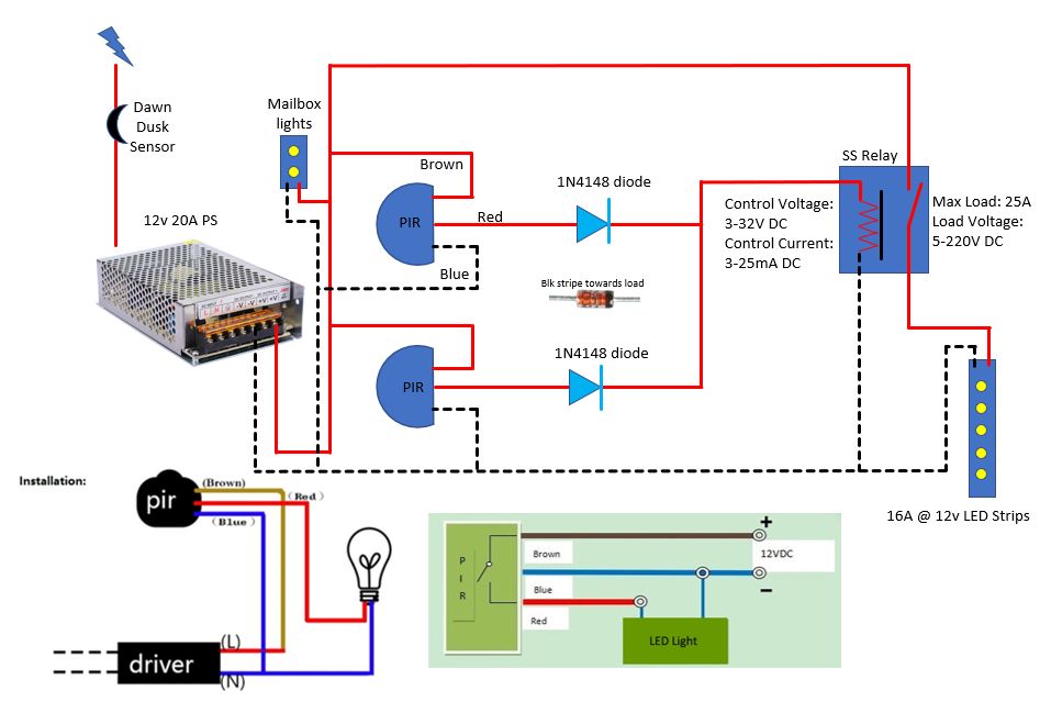

I'm building a small driveway lighting project, discussed in this thread (and a couple of others here):
Circuit schematic attached.
My questions:
  1. is it safe to enclose a 1N4001G diode inside heatshrink tube (effectively using the tube as an insulator)?
  2. For this relatively low-powered circuit, is the relay really necessary? (My understanding is that the relay effectively boosts a low-powered signal to drive the device on the other side, assuming that device requires more power than the input can deliver.) The PIR sensor load side can deliver 5-100 watts at 12 volts; my 7.5 meter long LED strip will only require 27 watts.
  3. Assuming the relay really is necessary, must I use thermal paste (like to connect a cooling fan to a PC processor) to attach my relay to the heatsink it came with (the two were not attached; just in the same bag)?

I had thought to etch a PCB for the circuit, but the only discrete, bare electronic components are the two diodes (1N4001G) between my two PIR sensors and the relay. However, the only real benefit of a PCB is to physically and electrically isolate the two diodes while at the same time ensuring that they cannot touch. Then I thought: rather than go to the trouble of designing a circuit and then deal with caustic chemistry to etch it, why don't I just solder each diode to its PIR sensor's load wire , then attach another wire to the other side of the diode to go on to the relay, and then embed the solder joint in heatshrink tube? It would be far simpler. The question is whether embedding the diode in the heatshrink tube could eventually damage it - maybe the diode gets hot, the tubing prevents the heat from dissipating, and it burns out?

OK, maybe I've answered my own question about the need for the relay. Please confirm for me:
While the PIR sensor can deliver sufficient power to drive the LED strip, the diode cannot (its max current is 1 amp, which is only 12 watts in this circuit). Since the circuit requires 27 watts at 12 volts, or 2.7 amps, a relay is required to boost the current to what the LED strip requires.
Is this correct?
