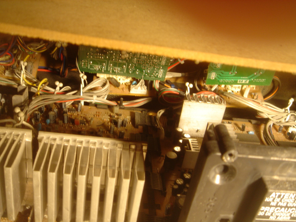

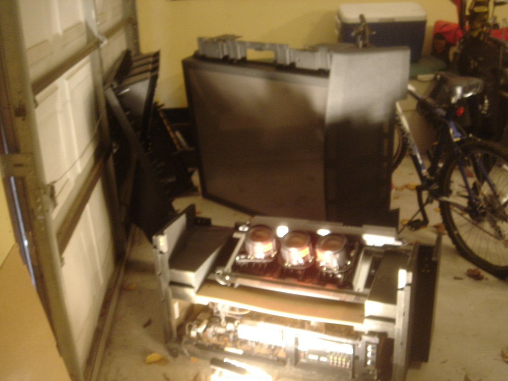

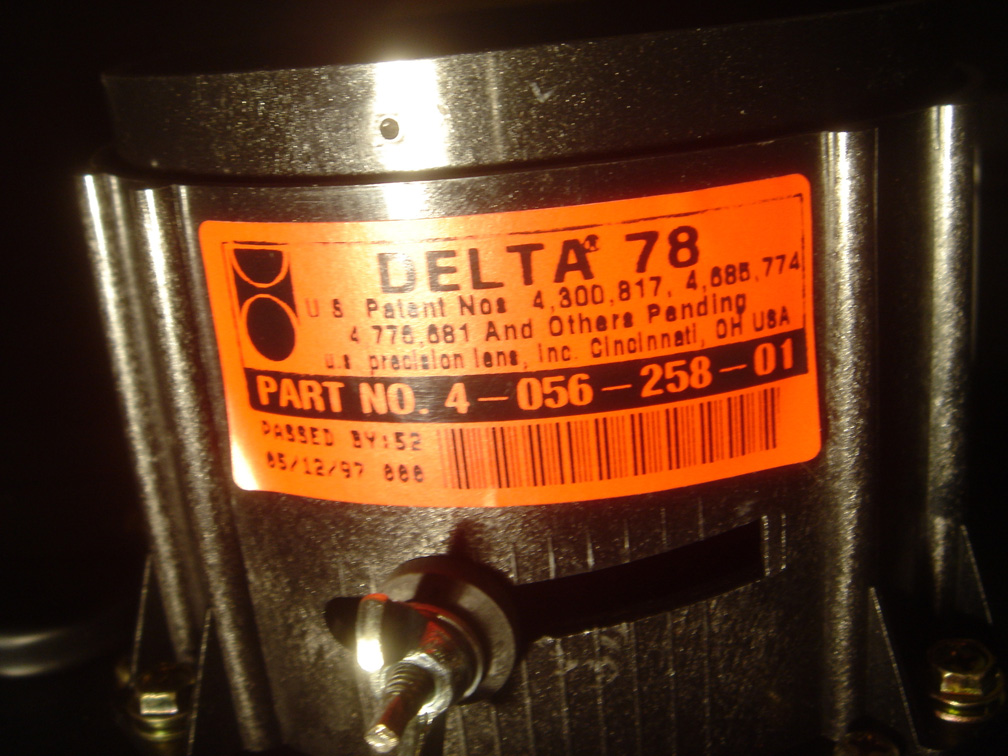

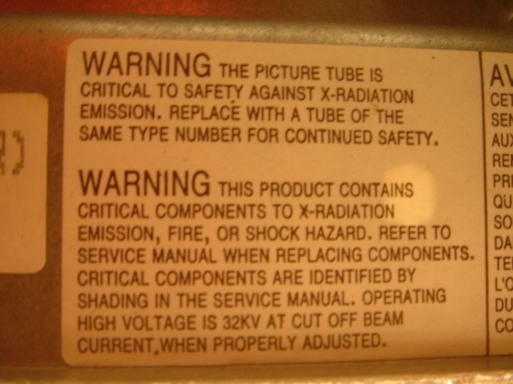

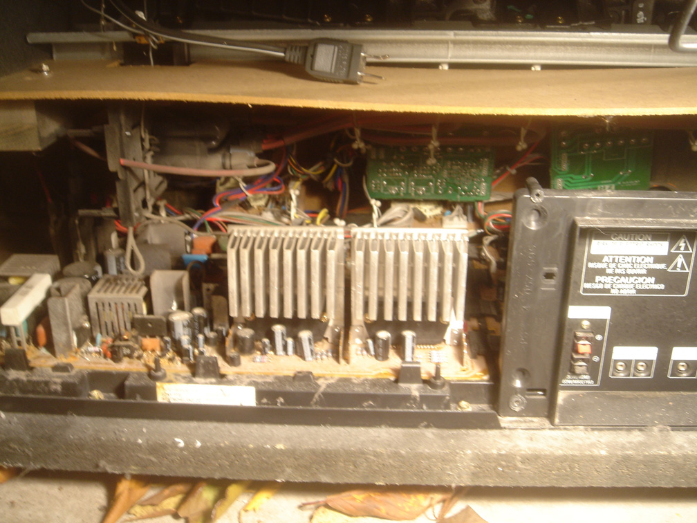

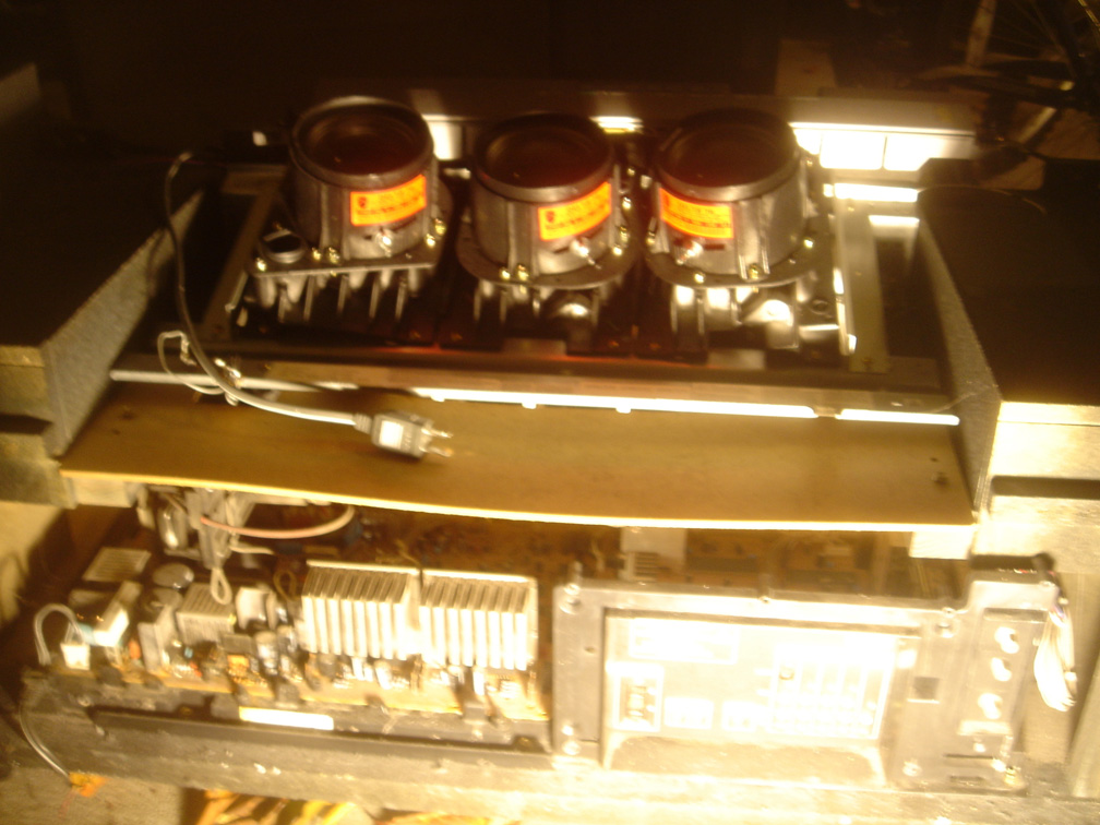

In Nov. of 97' my dad bought a brand new 53" (or 52") Sony Rear-Projection TV. Just over a month ago we got some water damage in the basement and the TV wouldn't turn on. Now its been sitting in my garage for the last few weeks and I want to salvage any valuable parts.
I don't know much about TVs but its got plenty of cool stuff in it and tons of warnings. I've seen in "make" magazine some pictorials on how to use the laser from a DVD player to melt things and other electronic projects like that. I dunno if this constitutes as hacking, but if you guys have any cool ideas or know of some valuable parts let me know.

You know those heat guns that are used to strip paint? If you suspend your circuit board horizontally between two posts and blow hot air from such a gun onto the backside of the circuit board then after a minute or so (depending on how close you hold the gun) most of the heavier surface mount parts will just fall off. Some plastic bits on the side you are blowing on will melt, so if you want those, take them off first.
Oh, and do this all outside or the gases will stunt your growth.
It depends on what you want to build.
The flyback transformer and voltage doubler (these are likely to be integrated in to one module) can obviously produce voltages of up to 32kV which can be useful for making a Tesla coil or just having fun making huge sparks.
There will also be many useful components like high voltage capacitors, transistors and resistors.
It'll probably have some ferrite cored transformers and inductors which are useful for building your own switching power supplies; ferrite beads can be used to make a simple circuit called the Joule thief which can power a white LED from a single 1.5V cell for many hours.
