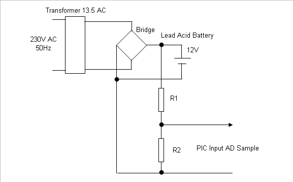

Hi all
I have a lead acid battery charger. It’s a simple charger.
What I want to do is measure its battery voltage from a PIC. The problem is the output voltage is unsmoothed DC (there is no any capacitor).
Will this be a problem when sampling? What are the precautions do I have to make?

What are the desired values of R1 and R2?
You can shunt R2 with a large capacitor to create a low source-impedance for the ADC input, and to get a modicum of anti-alias filtering...
Hi Mike the resister divider will generate 4V output when the battery voltage is 12V.
I don't know what is shunt and what is anti-alias filtering???
Is there any changes to do?

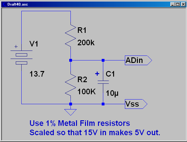

Using high resistances so that they do not rapidly discharge your battery if you loose AC. The capacitor satisifies the PIC AD requirement for a low source impedance.

Hi Mike that's exactly what I want.
Thanks for your great help.
One thing I cannot find metal film resisters so I used normal resisters.
I know resister divider will scale the input voltage.But whats that 10uF capacitor do?

I disagree. The DC input leakage spec on the AD input pin is +-1uA. The error caused by a 1uA change in input leakage current using the 200k/100K resistor divider is about 1% (about the same error as using 1% resistors), besides, the leakage current will me more or less constant, so it causes an initial offset.
The requirement that the A/D input is fed from a voltage source with a source impedance of <10K is met by the 10uF capacitor. The settling time is long, but since the OP is measuring a battery, who cares.

I agree with Mike that the source impedance doesn't need to comply with the less than 10k requirement due to the capacitor. The low source impedance is required so the internal sample and hold capacitor will charge quickly. With the 10uF cap (I think 1uF is more than enough) then the internal cap will charge almost instantly. However, I would suggest dropping the values to 50k and 22k and making sure you have a low leakage capacitor.

You labor under a common misinterpretation of the meaning of the 10K source impedance spec. Pommie has the correct explanation of why only the AC impedance needs to be low; the DC source impedance can be 67K without becoming the dominant source of error in reading the battery voltage. The error due to using 1% resistors is significant.
Besides, I have done this, and it works just fine...

Mr Al, you just repeated the misconception AGAIN without answering any of the points that Pommie and I posted in response to Oznog's post. If the source impedance is 10KΩ or less, then the external source tied the AD input pin is low enough to prevent the capacitive coupling backwards from internal switches from perturbing the voltage at the input pin. This is a dynamic process (AC) which happens only during the conversion sequence.
The external shunt capacitor will present a source impedance much less than 10KΩ and will hold the voltage constant during the conversion. Think about how much current it would take to "move" the capacitor voltage.
This is independent and separate from the DC leakage spec, which slightly changes the DC level at the input pin.

Keep in mind that the capacitor we are trying to charge is only 25pF. A 1uF external cap will charge it almost instantly and it's voltage will not be effected (that you can measure).
sure, then you just have to wait "Bla" Seconds until you can take another accurate sample, Why not just do the right thing to start with and put an Op-Amp in there as a buffer? then you can use very high value resistors and still have the right impedance at your AtoD Pin.
You don't have to wait at all and there is no need for an opamp. What you are suggesting is just complete overkill.
