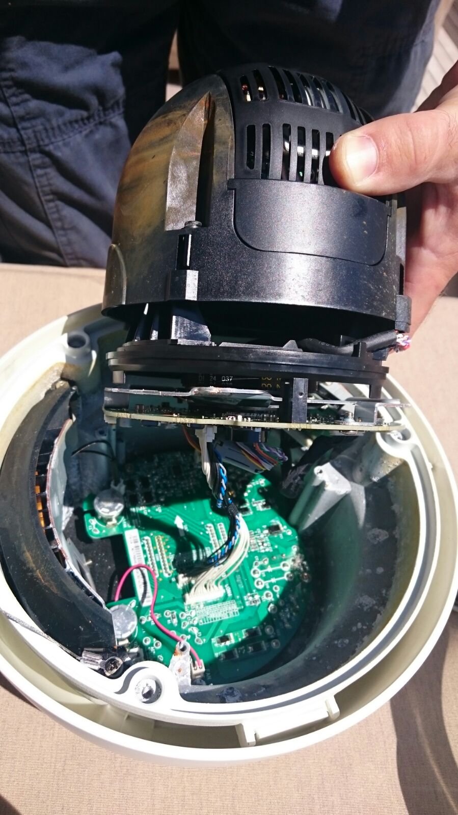

I´m repairing this camera which had water inside. I repaired some problems on tracks due to water and I also found a shorted diode (D14).

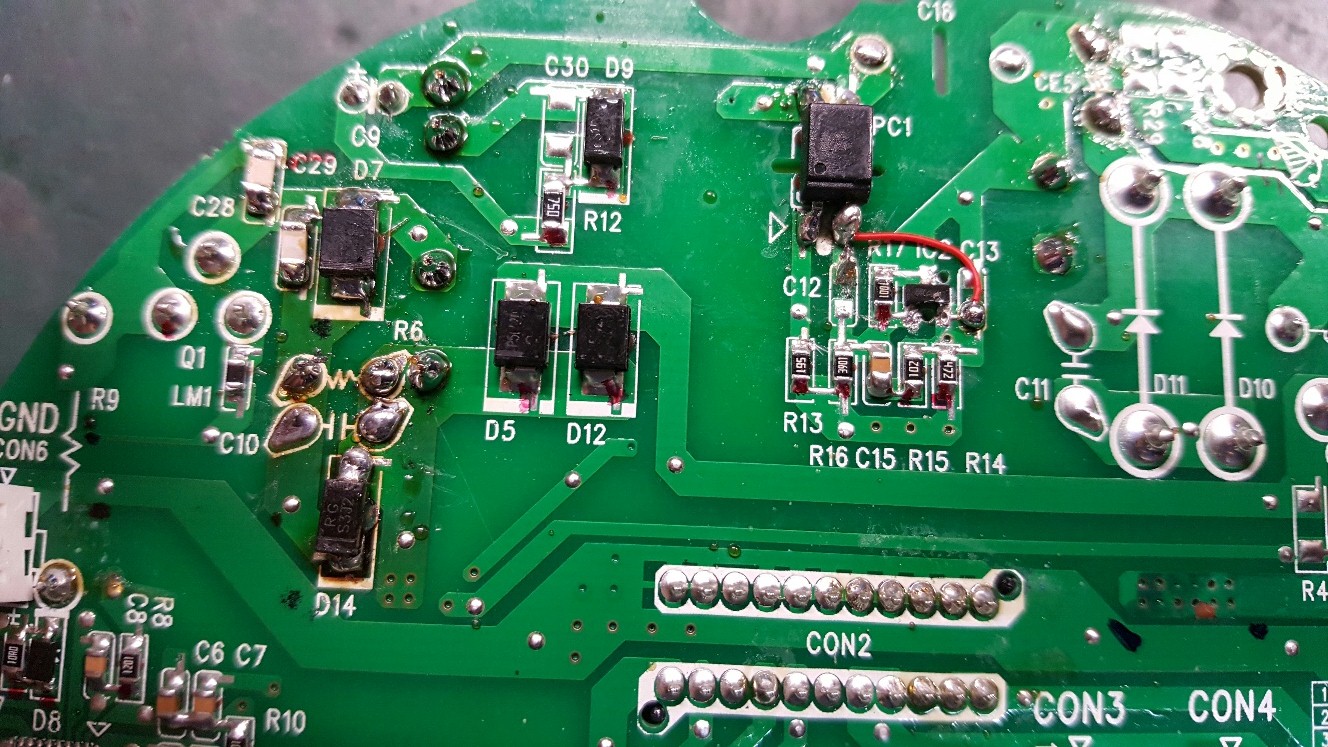

The power supply had cycling symptons until I found a broken track from one side to the other of the board, this was at the feedback side so that behavieur was normal as it didn´t get the feedback voltage. The PWM IC is TPS23754.

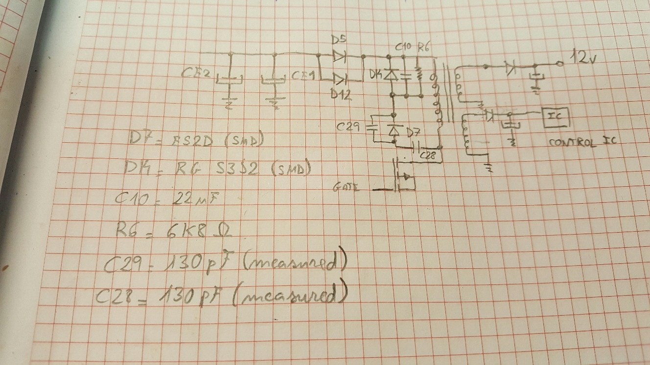

After repairing those things I get normal and good 12V at the only output of this transformer, the problem is that D14 is getting too hot. You can see D14 at a quick and partial schematic I made. I have tested all components at primary side and I don´t see any bad one. Which could be the reason for getting D14 so hot? I think if I leave more time it will be damaged again. Thanks for your help.

What diode have you used for R14?
I put original diode because in fact they gave two cameras, but one of them was in very bad condition so I didn´t accept to repair. I took a diode with same reference which I would say is S3 code:

I don't really understand what's going on in that snubber network (it looks a bit unusual to me) but C29 and C28 seem a bit small... I don't know if that points to some kind of problem in that area? I can''t see why one/both of these failing low-value would cause D14 to overheat though.

there is a fault in the schematic, C28 is going to source of mosfet. What I´ve tried is to replace D14 by another diode more powerful and see what happened, I used these ones:

With all of them the power supply output is going up and down a little bit, less than 1V but with the original one it´s stable. I want to be sure what type of diode is this RG S3J2 to put one with the same functionality but more powerful. I´ve seen it can be also SMAJ58A but I´m not sure if it´s matching in this snubber network.
I would have thought that the parameter most likely to cause trouble here is the reverse recovery time. So as long as the diode can handle the voltage and current, the faster it can recover the better.
Do others agree?
