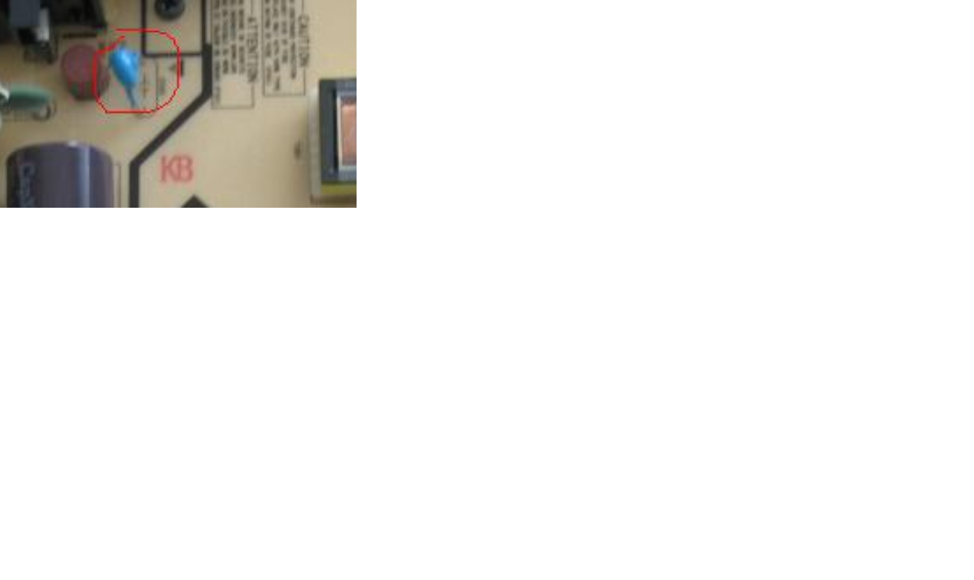

The caps I telling abut are like those ones showed by red in the below pic. the below is not the board I have but it is somewhat similar and the caps are placed at the same position.
While the TV stops working and just speakers does work I put the hot air hair dryer near them the TV starts to work normally! And it works for almost several hours and the problem apears while the TV is turned off and then turned on.

Like I said, it would be VERY unlikely for those kind of capacitors to cause the problem you're having, but feel free to replace it if you wish and see what happens.

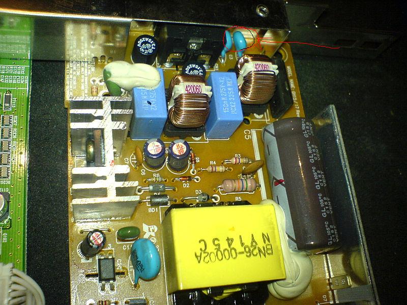

The board has a cap like the one I showed in the below pic (the green line) labeled (labeled on the board itself) as CP815 and 2 other caps I showed with yello lines labeled AS cx802s and CX8015.

Well, I replaced several of electrolyte caps On the PSU with new ones purchased from my local electronics shop store, Now the TV Inductor red led blinks for few seconds and then turns off, it means that the TV does not work at all!
Any idea what's the reason?

Wrong values?, wrong type (they must be decent quality, low ESR, and 105 degree), or you've done something wrong - such as wrong way round, or created a short or open circuit on the board.
Were any of the old capacitors bulging?.

In the picture you can see the main HV filter cap is bulging!
It's hard to tell in that picture, but it certainly could be.
If it is, it's pretty easy to test, because it's a low frequency capacitor (100/120Hz) - and a simple capacitance test will show if it's faulty or not, they commonly go completely O/C, yet the supplies often manage to run even without it!.
