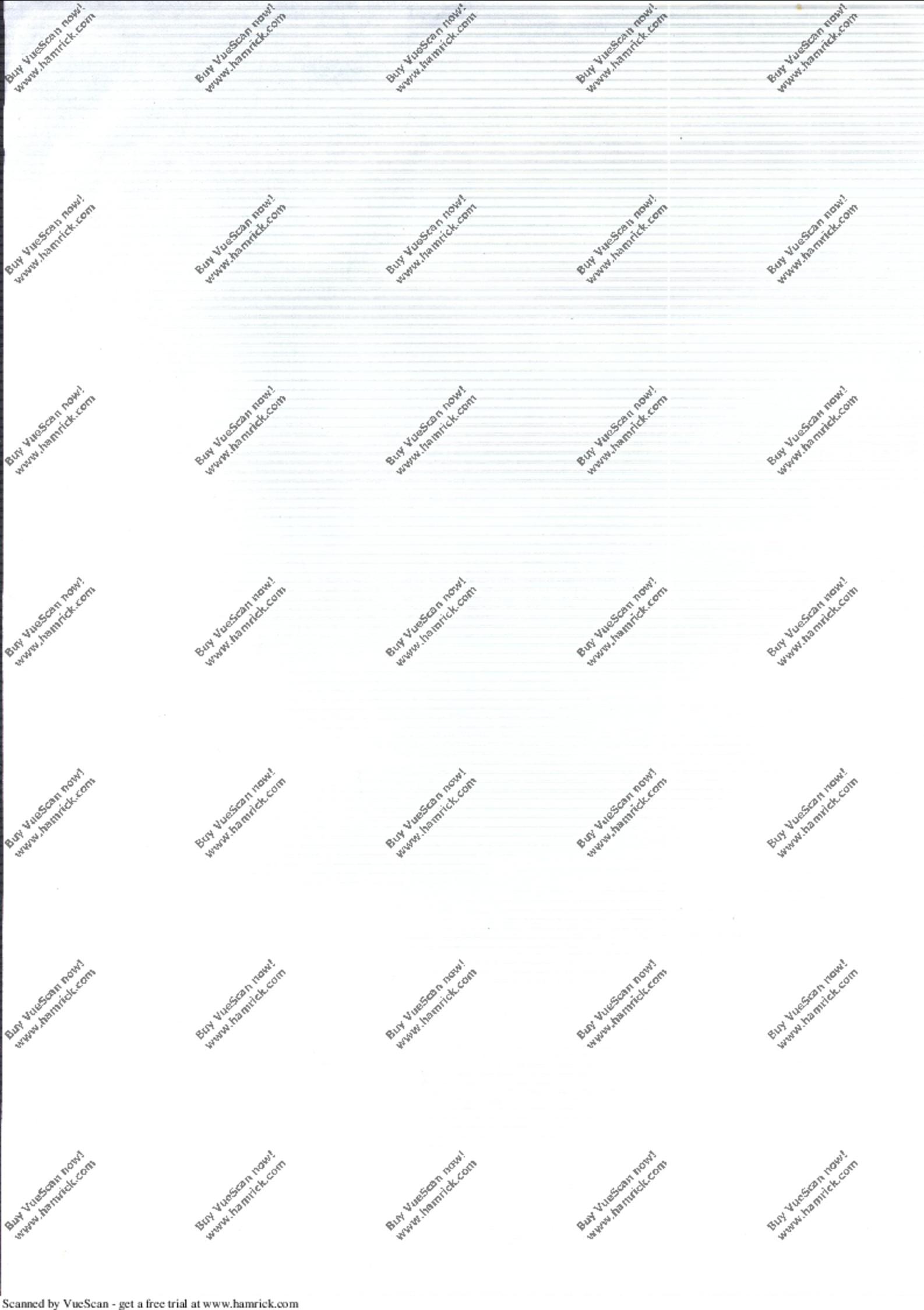

Hello to everybody. I got an old broken scanner and I wanted to repair. The job looks easy at the beginning but I get stuck and I need some help.
The scanner is an Mustek BearPaw 4800TA II. When I scan documents, in the direction of scanning appears some stripes from beginning to the end of document. I cleaned all the optics with clean cloth for glasses and liquid to clean glasses but I didn't see any improvements after that. I use the drivers from mustek and I download vuescan free edition to make a try. On the attached file it can be seen the stripes. If more pictures are needed, please let me know. Thank you in advance.
I think you may to try some more aggressive cleaning.
Witch way is it scanning in reference to your picture?
If its top to bottom it could possibly be a speed issue. IE to slow in the beginning?
My guess would be the light tube , taking time to get up to full brightness . "old" would be the clue.
If what we see at the top of the image is scanned first, it seems in agreement with what GD says.
Just by watching how my scanner works, the warming up time could be out of your control. In other words, you could not start the warming a little before than the actual scanning.
Any way to measure voltages? Maybe there is precisely one taking too long to take off. A tough one this. . .

Yes it start from the top of the picture and I observe that on black and white option the stripes aren't so visible. It appears if I skip warm up or even if I double warm up cycle in software. The speed of motor looks ok but I don't know if I can find a new light tube. By the way, I mean old both, it was bought 10 years ago and it was use quite frequently. I'll try one more good cleaning and try to have a software calibration. If anyone has other ideas, please let me know. Thank you
I don't know why I didn't think of it but I think the old lamp may be your most likely scenario. They are probably only good for so many hours.

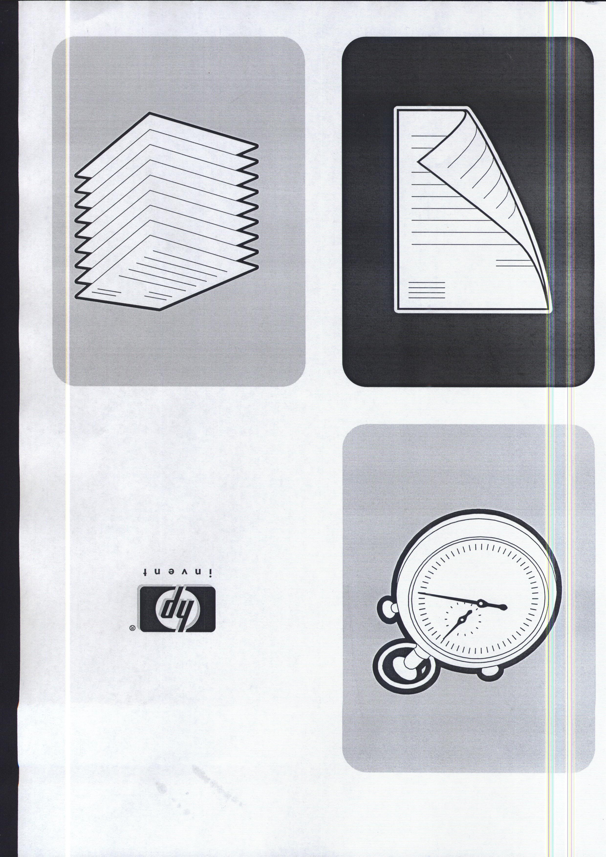

I have a bad news and a not so bad one. I started to rub all the mirrors and lens, result, no more horizontally lines but I got a prize( I don't want it) vertical ones like in image
Unhappy after this I tried again but the result was worse, another line on the left. And this is not all, now when it start the motor make noise.
To clean I tried glass washing liquid and alcohol, last variant seems seems to be very bad. Thank you for any new idea.
Some of those vertical in the first scan seem gone. Am I right?

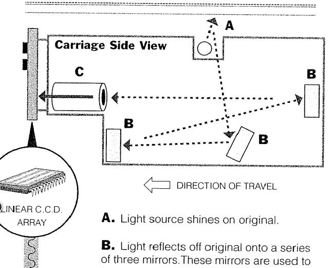

Those mirrors are most likely first surface type where the reflective surface is on top of the glass instead of the underside like a bathroom mirror. You mave have scratched the reflective surface.
just a guess, but those lines don't look like dirt as the first ones do, more like the top of my tv when i mess with v-synch and the top image folds over,
is it possible that something could have gotten misaligned? pushing gears alignment out of wack when rubbing?

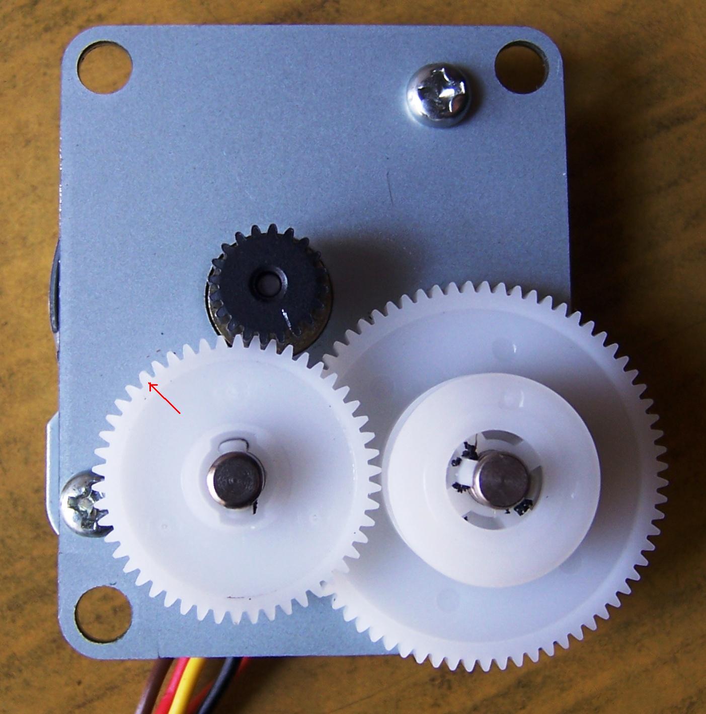

Hi Fred Juire,
it has to do with the traction motor and the nylon gears used therein, the teeth get de-shaped or worn and the traction belt also get stuck at times you hear tic-tic sounds while tractor is moving
Once you could get and replace the wheels , the scanner works
Perhaps a timing belt changing should not be a problem.

Thank you Mr. Sarma, the gears looks fine but the traction belt it is old. I tried to find parts but for the moment I didn't find. I even think if it worth to change if is too expensive. I'll have some more practice and hopefully find a solution.
you may see my case where little dented teeth (Marked) of the gear of the scanner

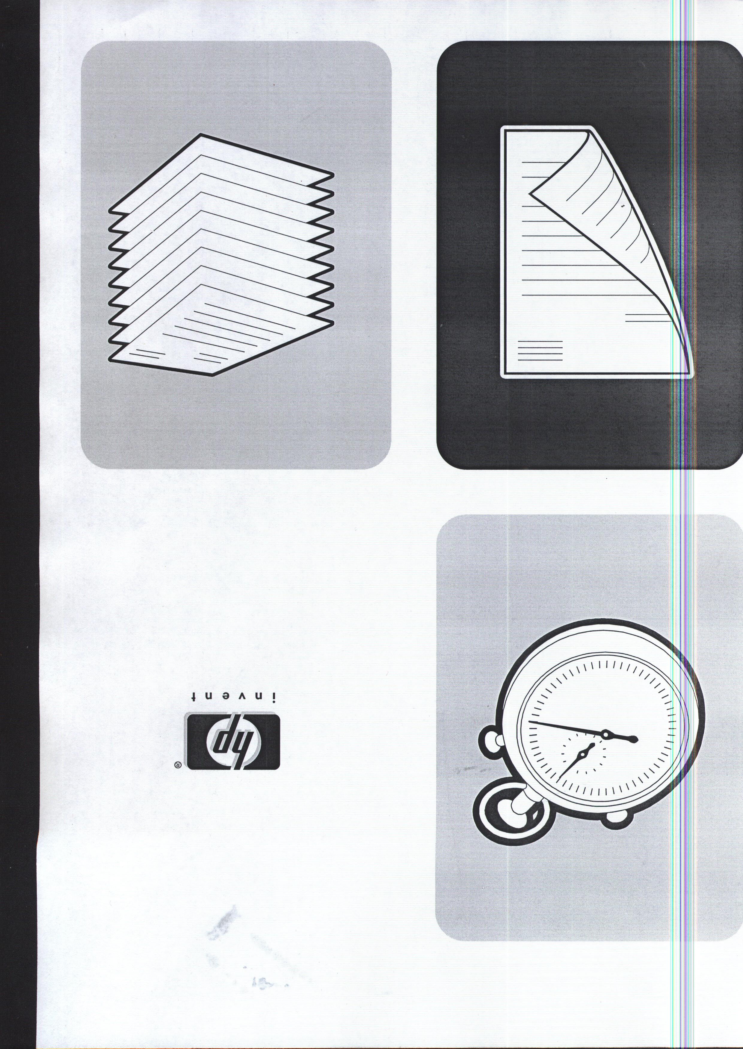

I checked my gear but I didn't find anything but I thought I understand how it works, everything goes wrong. After that noise made by the gear on the belt I checked the optical sensor and I obstructed it to see if the motor stop, but nothing happen. I thought that the sensor it doesn't do its job, but after I assemble it again everything works fine, no more noise but the scanned document still have some shadows and just after some scanning a vertical stripe appeared again. By the way, I didn't tell that I don't have the original power adapter(12V/1.5A) and I use another adapter(12V/1A). I checked to see if get hot but looks to work fine.
