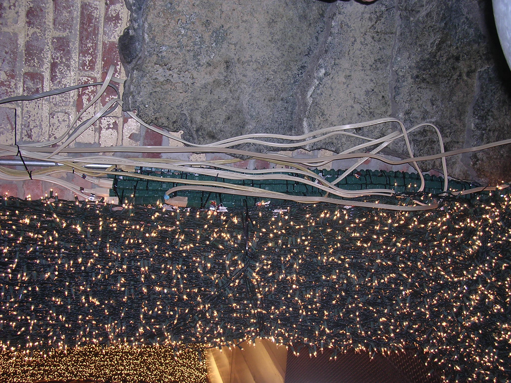

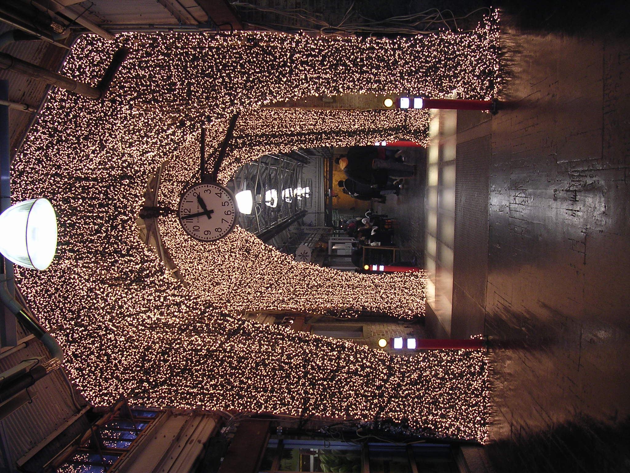

It's getting near Thanksgiving so I figured I'd drag these out.
This was a few years ago at Chelsea Market in NYC (home of food network), the day before thanksgiving. Being an electrician it scared the h&ll out of me.
Walking through the tunnel you could feel the heat and smell the hot plastic. Considering the place was packed with holiday crowds made it even worse.
Those are 5'(!) tall stacks of piggyback plugs (50 or so each), 5 per leg of the tunnel. That's about 1,200 strings! :eek: The extension cords were hot and soft.
You do have to admire the ambition of whoever created it though.

What do you think the current draw of that is? Wonder what kind of breakers they had... if any.
Appliance extension cords. None of the light strings look unusual, they probably have their inline fuses intact. I honestly don't see anything sketchy, in fact it's a damn neat wiring job.
The last set of mini lights I had similar to those were about 1 watt each.
So assuming those are the fairly standard 35 bulb strings and there are 1200 of them thats about 42 Kw of lights. :eek:
Or about 350 amps at 120 volts which works out to about one 20 amp circuit per stack of 50 strings and likely using 20 circuits total.
Just guessing based on rough numbers though. ;)
But still thats a load of heat being dissipated with all those bulbs! :D
But still it would likely pass code!

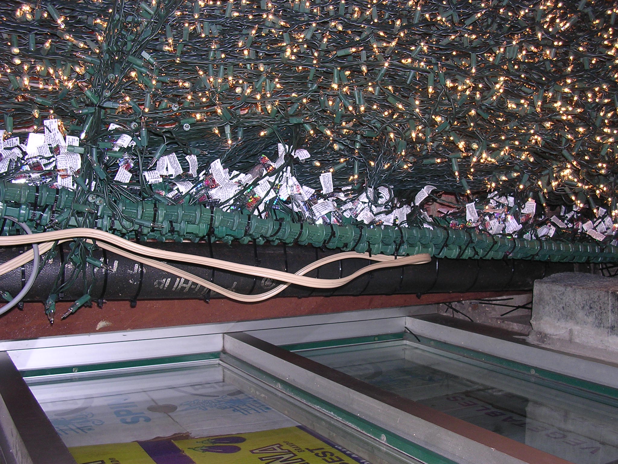

The 14 gauge (if I remember correctly) e cords were hot and soft. The problem I see is that I seriously doubt that the piggyback plug at the bottom of the stack is designed to pass 20 amperes. The fuse does not help with that.

The photos don't do justice to the amount of effort that went into this, safe or not. The lights were laid in with mind-numbing precision. Serious man hours here and a bazillion zip ties.

Warm and soft most definitely IS a problem when talking about building wiring. That's how fires start. Just because the UL listing says that piggyback plug should be able to pass 15 amperes doesn't make it a good idea, We are talking about a crappy mass produced light string here, not a quality plug and socket. A quality commercial grade cord cap costs as much as that whole light string.
I wish I had read the tag on one of the strings. If they are 50 light strings then they are about 25 watts per string so about 10 amperes total. If they are 100 light strings then 20 amperes total. Those extension cords and piggyback plugs are only rated for 15 (maximum continuous load of 12A!). I tend to think that its closer to 20 based upon how hot the cords were.
Were talking about a public place of assembly here. Not where you want to start taking chances with fire hazards.
