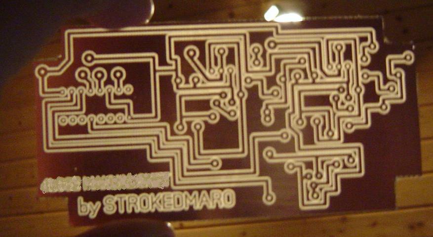

2. Ive finished etching out a PCB for my latest project but I had a thought while laying in bed last night....is there a formula to know how much current can flow through a copper trace before it fails? The trace in question is 1mm wide, 1/2 oz copper which needs to carry approx 1 amp at 12vdc. Just doesn't sound reliable to me.

Here is a tutorial for PCB design. Page 7 shows a chart of trace width and current. One amp will create a 10C rise in temperature with 30mils of trace. There is a big difference between 10C and failing.

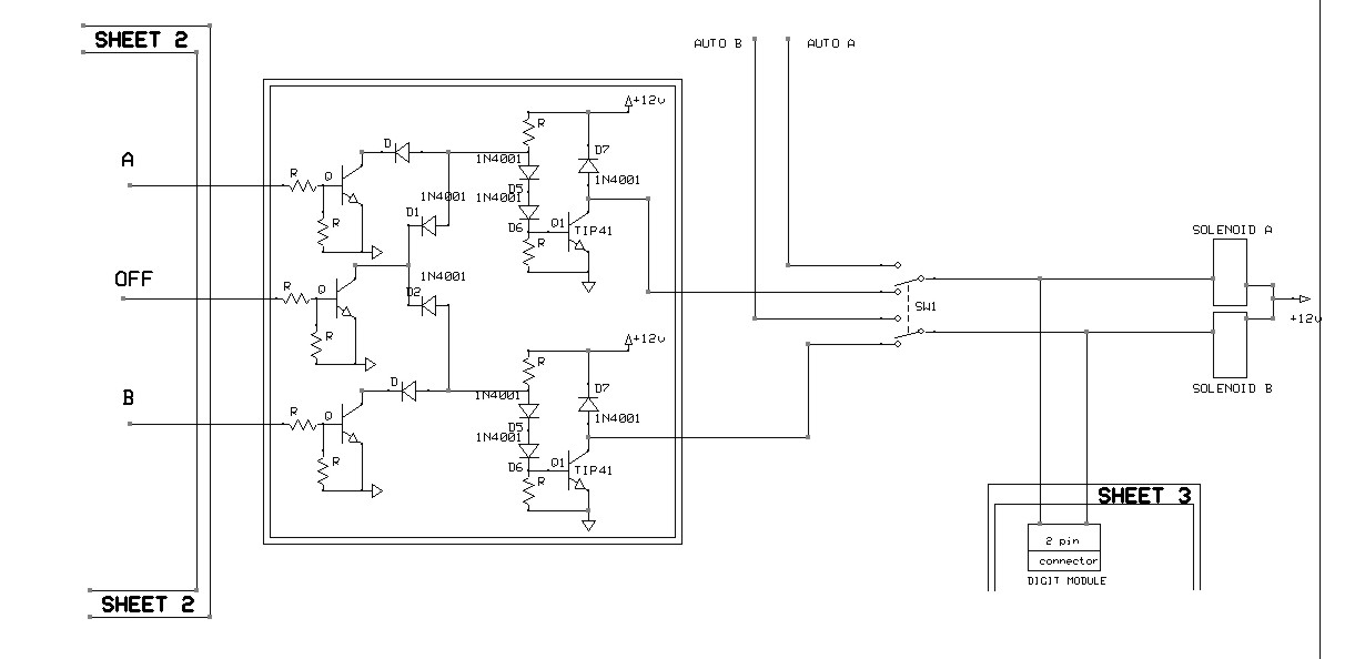

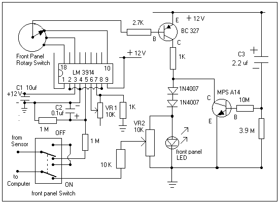

here are 2 schematics with the double diodes. What would be their purpose in each diagram? Would help me understand a little better for future designs.

In the second circuit the MPSA14 can not pull ( C ) all the way to ground. I think the A14 is a Darlington and with 10M on the (B) it is lucky to bring ( C ) to 1 volt. The voltage on VR2 needs to go to zero volts. The two 1N4007s will drop 1.4 volts. SO: If MPSA14 is on but with 1 volt across C-E then with the drop in the two diodes the voltage on VR2 is zero.
Circuit one has the same thing happening. Starting on the left side. The first 3 transistors can pull their outputs very close to ground. (.2 volts) Then there is a logic made of diodes. (A=top, B=top & bottom, C=bottom) By the time you get through the diodes there is 0.7 volt loss. (.2+.7=.9) Now a low voltage is 0.9 volts. But we need to turn off the TIP41 where anything above 0.6 volts is on. The diode pair loose 1.2 volts ensuring that the base of the TIP41s will be at 0 volts when off.
So, after looking at the table of current vs track width I should be more than good. 1 millimeter = 39.37 thous. My 1/2oz traces at 1mm wide are roughly double what is necessary to carry 1 amp! This should also give me about half the temp rise also...about 5deg C. THANKS!!!
I'm glad I don't have to re-etch this board...thankfully even though this was an afterthought, everything should work as designed. Attached is a pic of the board.

As you read thru the tutorials you will see that track width and current capacity are not the only criteria for a 'good' pcb.
You should consider the layout of tracks relative to each other for the signals the track carrys, screening. etc
.... also 90 degrees change of tracks will give less mechanical stability in case the board becomes hotter than assumed. Twice 45 degrees results in the same direction, but with split stress on the trace.
That way traces become shorter, too --> shorter trace --> less resistance --> less heating --> looks nice too. :)
