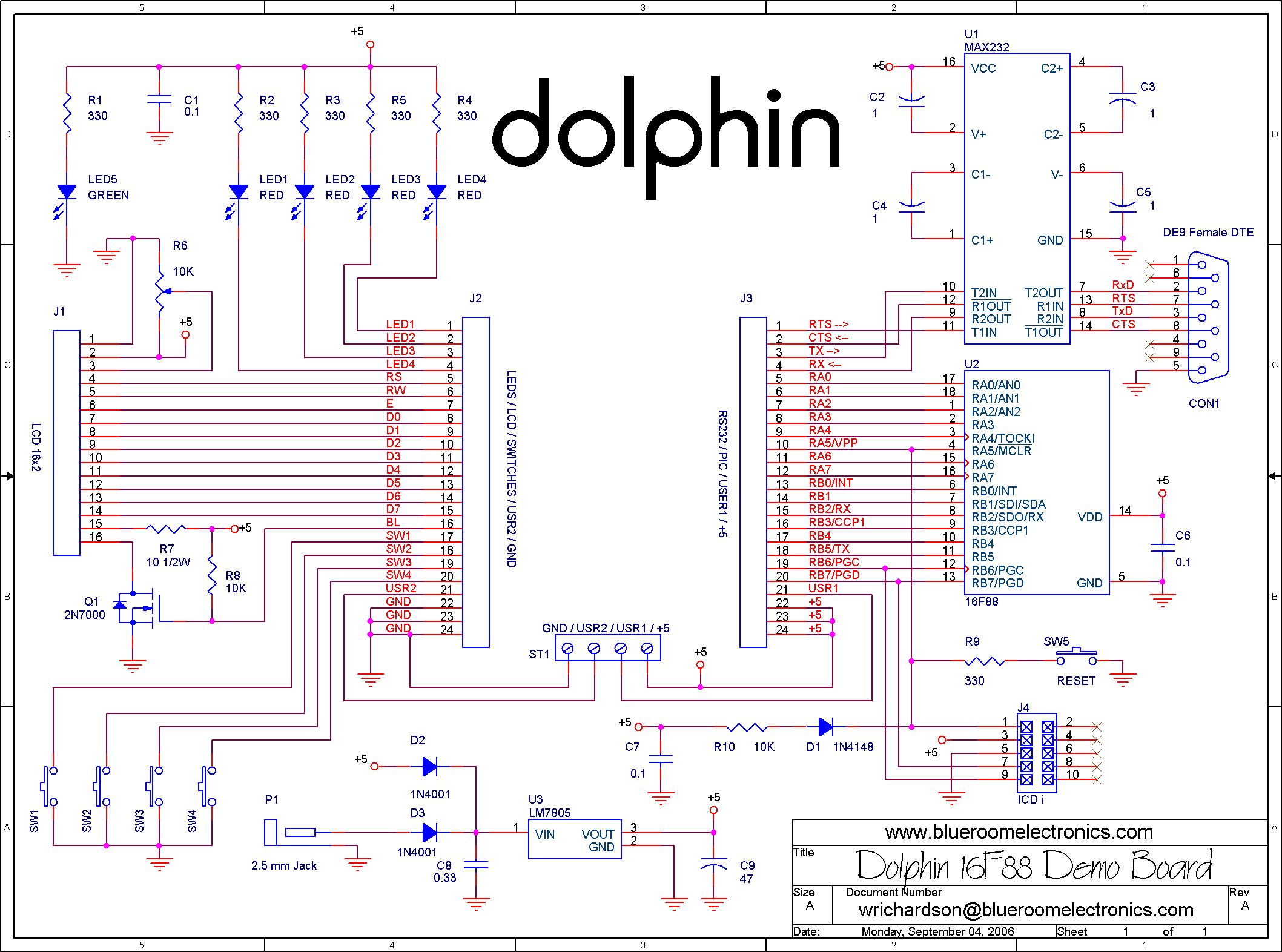

Schematic Dolphin Protoyping Board

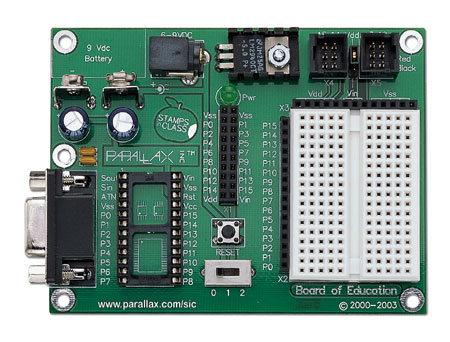

Here's the schematic for the next PCB Dolphin Prototyping Board. It will be available in kit form and was designed as a companion to the Inchworm ICD2. I think the 16F88 is a great chip that both students and hobbiests will find as a great replacement for the old 16F84. Incase you wonder what a prototyping board looks like I've also attached a similar type of board (Parallax)
Opinions welcome.

You might consider replacing the max232 and DB-9 with a USB connector and a FT232R USB UART IC. Many new computer do not have serial ports and it would help to set your board apart from others.
