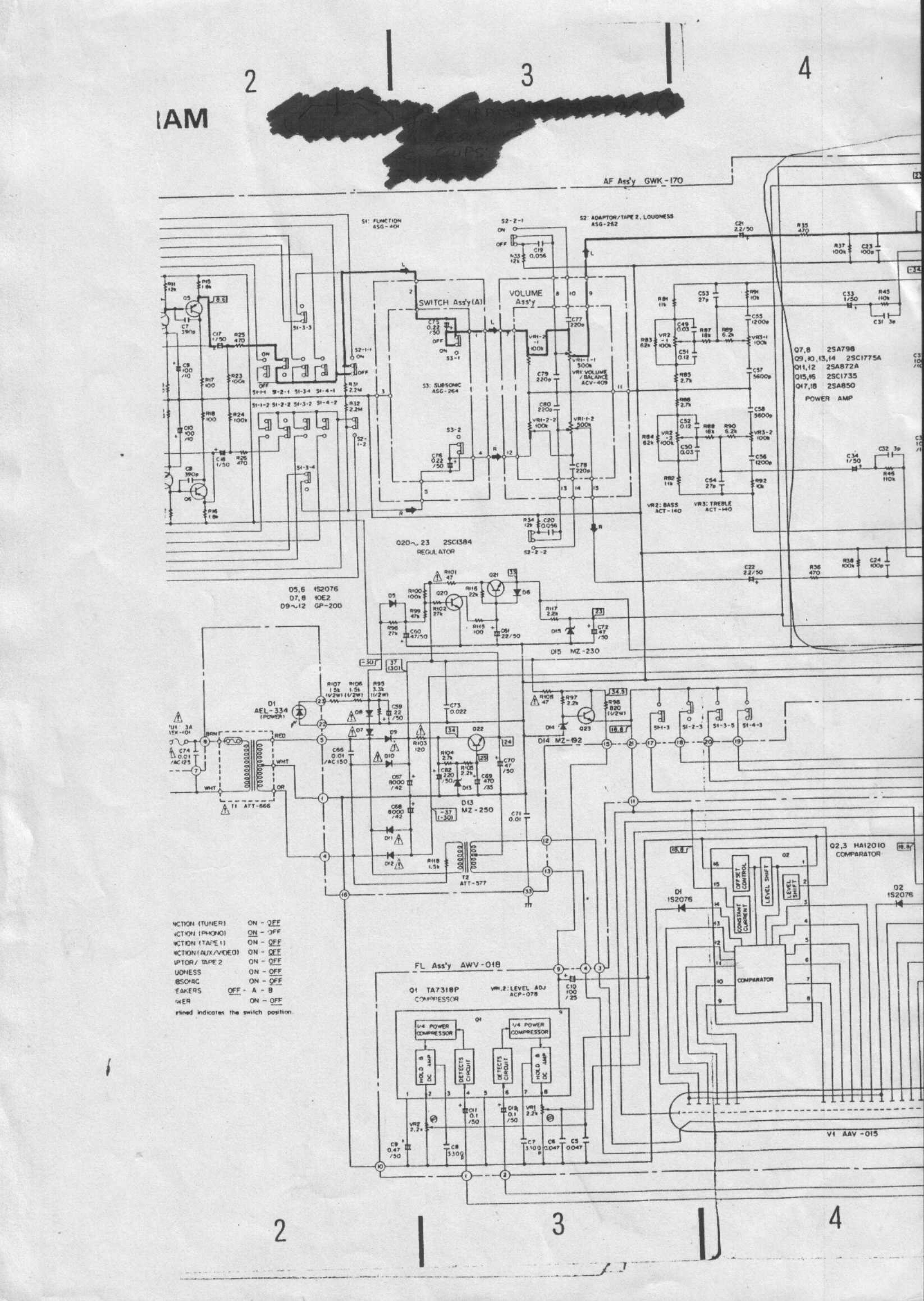

I need schematic for audio amplifier Pioneer SA-510 ... I found 2 transistor per channel.. made by NEC, but I don't find datasheet for this
D883A = 2SD883A and B773A = 2SB773A ? true or false ? :shock:

I found a Manual for a SA-500 and a bad schematic for a SA-520

Here is the Sa-520 Schematic

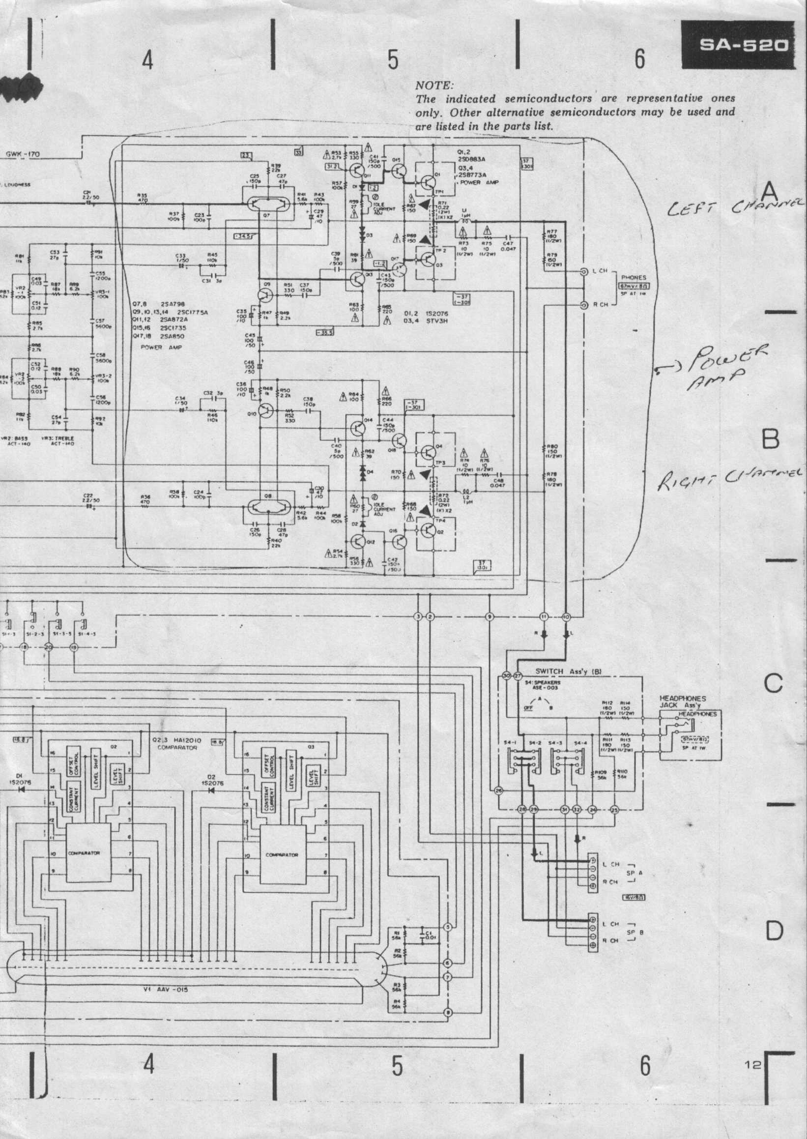

Here is a Schematic for the Pioneer SA520 Sorry it is not that great but may help.
Hi Hotwaterwizard. Thank you for the SM. It seems it would be better to obtain the exact transistors. I came accross a store in UK, which have some stock. I checked every single component, and they are all good. The replacement transistors seemed to have gone into thermal runaway. I see Pioneer used a different Diode matching circuit when they used the 2SA1104 on the SA-540 amp. With some patience, I can probably make the circuit changes, but i thing getting the identical transistors is MUCH easier...
I also see on the circuit Idle current adjustment, which I find strange. There are no adustable resistors in my amp. I have the Euro model.

It seems that I may have a biasing issue. The schematic shows "Idle current adj" I do not find any adjustable components in my amp. Any advise how I have to adjust the bias? I do not seem to have the entire service manual. I find many equivalent transistors, but not the exact ones, so I will have to play with the biasing... Anyone that can tell me how? Thanks.
The bias current adjustment is simply cutting a wire link - which will INCREASE the bias.
If you've fitted other than the exact original transistors then you will probably have to make the bias more correctly 'adjustable' - add a 10K variable resistor between base and collector of the Vbe, the lower it's set the lower the bias
Hi Nigel, Thank you for the advice. Excuse my ignorance, my text books referred as Vbe being "Voltage between base and emitter" will you please draw your suggestion on this? View attachment 63313
