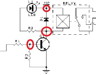

Hello everybody,
I am trying to build a PCB layout out of a schematic, but since i am new to this i have few problems with reading the connecting dots. Now i have the picture of the schematic and a picture of the PCB that i draw and was wondering if somebody could have a look at it and tell me if the connections are wrong. Thanks.

Other than having your led on the circuit board shown backwards and no visable V+ connecting track to the relay it all looks good to me.
Edit:- on a further look i think your transistor is backwards too. (it is a NpN transistor isnt it)
Look at the bright side... you got the resistors around the right way, O'yeh and the diode.

Hi Rocketman,
I wonder how you managed to get the transistor backwards onto the PCB.
The only explanation I can find is that you designed the PCB apart from the schematic design.
Here is an example what your PCB could look like.
I added three extra solder pads to connect the input for the transistor as well as the supply source.

Wow :) this is more than enough. Thanks for all the help SaBorn, Pete and Bonsuk. As for the schematic it's only a part but i really would like to finish the little project i started. About that transistor well i never used a program before so i installed Sprint Layout and couldn't find the right transistor :), but i did..... eventually.
