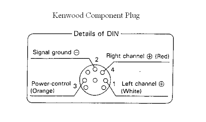

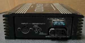

I have a Kenwood KAC-7020 amp but have lost the input connector. There are 8 wires in this cable and I need to know what goes to what.
I need any schematic or datasheets for this amp.

I found this in a KAC-720 Owners Manual.
