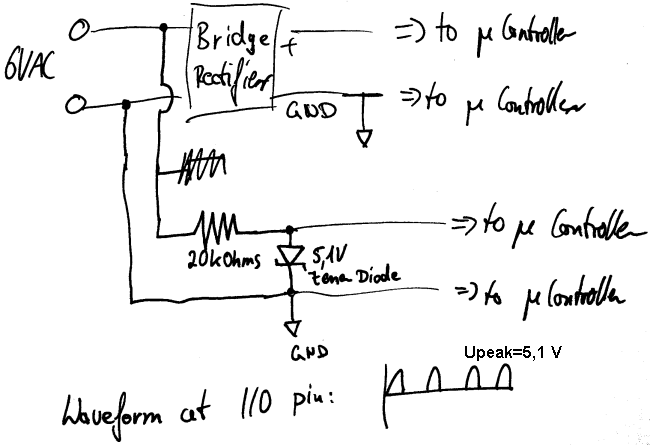

Now here's another idea, but I'm not sure if that would work. I think this could probably create a short circuit along Ground, frying the bridge rectifier, but I'm not sure of that. Please verify this schematic or declare it as rubbish ;)

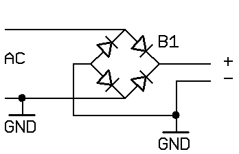

Here's what you are proposing. see anything odd about it?

Would placing a galvanic isolation (1:1 transformer) before the resistor and the zener-diode help? It should work then, shouldn't it?
The grounds at either side of the rectifier shouldn't be connected, it will short circuit two of the rectifiers!
Yes, I know (at least, I do now). But that's what I mean: If I put a galvanic isolation between those two - the problem should be solved, rite?

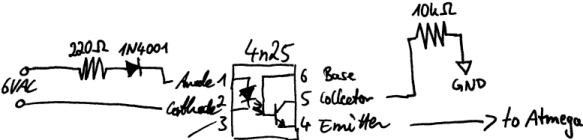

Alrite, this is what I've developed. Please verify that this works or does not. Is it possible, that I need to swap collector and the emitter?

nope, that won't do it on several fronts.
first, your photo transistor is wired wrong. emitter to gnd, collector connected to +V via a 10K resistor (you can play with this value for more sensitivity). input to the avr is from the collector. It acts like a switch. when it's off (darkness), the collector to gnd voltage is close to +V. When its on (light), the collector to gnd voltage is very low because the transistor is conducting. it's just like a pulled high switch, in that regard.
secondly, your led resistor seems a bit low. your 6VAC is going to peak at 1.414*6 or 8.5V. The 14001 will take a .7 forward drop and the LED has a max Vf of 1.4. That leaves 6.4V. I would target an If of 10 mA so that means a 640 ohm resistor. next standard size up is 680. If you want 20 mA If, use a 330 resistor. While the led can handle higher, I wouldn't push it.

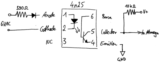

now, second try. I don't want to go too high with the preresistor, because the LED is specified to survive up to 60 mA continous. 390 Ohms should do, rite? Btw, what am I supposed to do with this base? Do I actually need that at all in an optotransistor?
