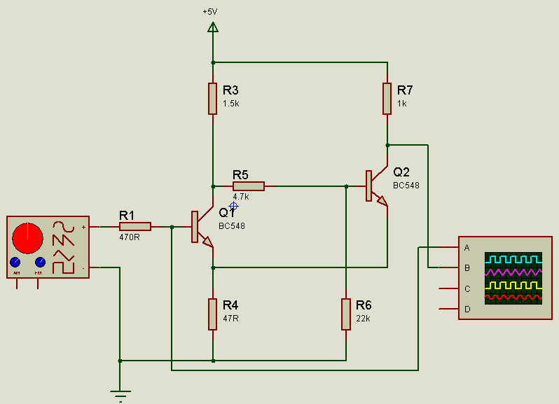

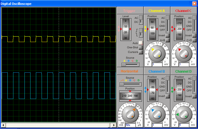

Hi Mathieu,
may be that circuit fits your needs. It can take any frequency from 1Hz to 1MHz without losses. At 10MHz the output voltage decreases.
The scope shows 10KHz at 1V input. (yellow=input, blue=output) The output swings to almost VCC (5V).
I'm using a modified circuit for zero crossing detection in an AC motor control circuit.
Boncuk

Hi Mathieu,
Boncuk

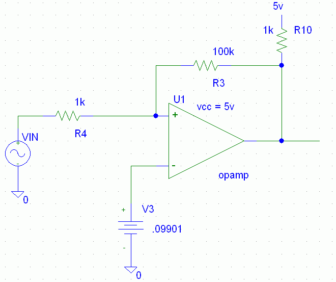

As for a schmitt meeting your spec, see attached cct.

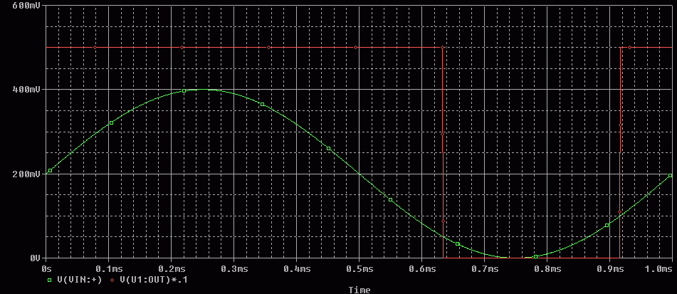

How did you work that out? I've attached the simulation; it's pretty clear that it switches low with 50mV input, and high with 100mV input. I fail to see where the confusion is (be it mine or yours).

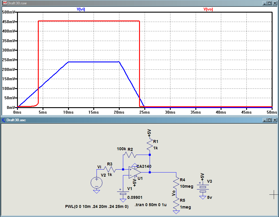

hi dougy,
Ran a LTspice on your OPA comparator, I get 50mV and 100mV as the switching points.
The 10M and 1M are used to make the plot easier to read, but have minute effect on the thresholds.
