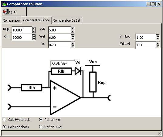

if you install PYTHON and the GTK+GLADE libs I am working on a program atm
I have no spare time atm (a project at work getting into hardware testing and I am moving house).
This is in a usable state (be it a few maths bugs)
Hopefully within a month I will have it finsihed then I will package all the libs and runtime environement together into a single installer so you wouldn't have to isntall:
python, GTK,GLADE

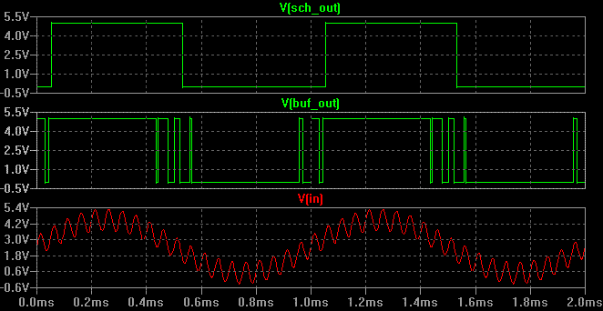

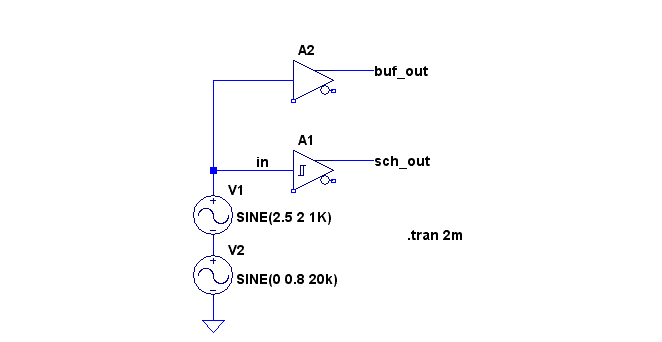

Below are some waveforms to illustrate what Styx is saying. Note that the buffer has no hysteresis, while the Schmitt trigger has (in this case) 2 volts of hysteresis.

Got it, thanks! That's why one picture is worthy more than a thousand words..
Now I understood why schmidt triggers are good for debouncing switches.
