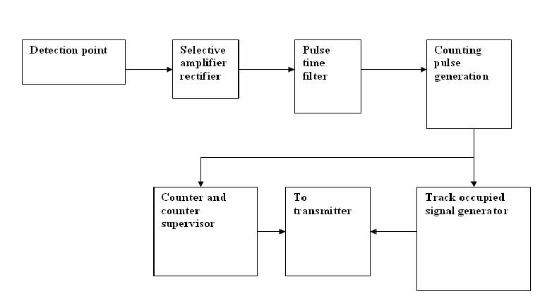

I am designing a system for railway crossing signaling system. My design is
{train detection using a induction method(done) }--->{selective amplifier & filter(done)}---->{pulse time filter(done: output is pulses equal to the number of axles in the train)}--->{counter pulse generation}--->{counter and counter supervision}---->{Atmel controller(done)}---->{RF modules: link(done)} --->{Atmel main controller}-->{track occupied signaling system}
In the above schematic now I need those counters. I ordered some samples from TI but they were surface mount. There I need a comparator to check the number of pulses which are received by two of the above system, to increase the reliability.

These days no one gos for 74xx. better choose 74HC14 instead of 74 plain
these are generally available.
HC688 is a comparator , 8bit though. while I wouldn't be into designing your project, I could only say that there is an easy way to mount SMD chips on Strip type board by splitting each track into 2 with a sharp tool. I saw some one demonstrating this. How ever, you are very likely to get 74HC seire like HC14 as suggested. also you may get 74HC40106. perhaps CD40106 is easy to get
