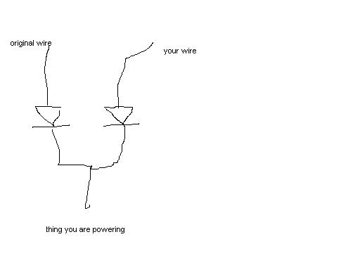

hey there I have one Q what is a diode and how do you use it in a 12v sistem to turn on a light but not to put the 12v back in the sistem of a car??

A diode is a component, ehich allows current to flow in one direction.
The diode conducts when forward biased, that is when current direction is from +ve to -ve of a diode.
A diode is reverse biased when the opposite is done.
Try to google for Basic electronics. You will get lot of info.
Take care...
Bye
Make sure the diode is large enough for the current you are going to send through it. 12V car batteries have a lot of amps.
What are you trying to do on your car, more info will help everyone help you.

Thank you for the info. I have been buzy latley and havent been back for some time..What I'm trying to do is to work lights and outher things that already exist on the truck without sending a surge back to the computer that controls the truck because it is a negive trigger sistem ..Does that make any sense ?? Ok try this...to turn the back up lights on at the back of the truck without sending power back to the switch on the traney and possibly causing damage to the system...How and what would the best way to do this????----OMATIC----

here you go...
