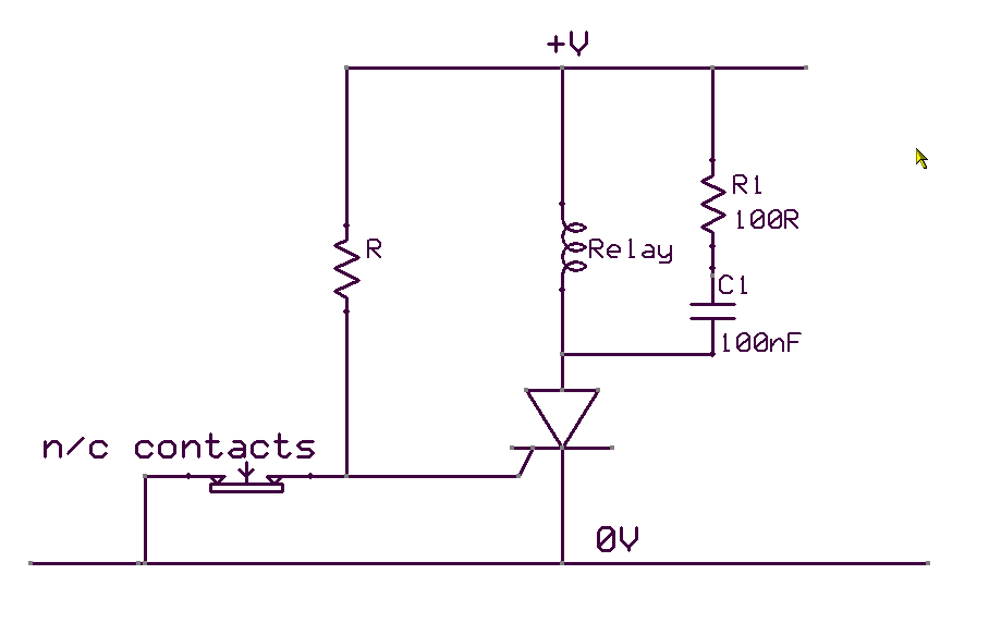

I need a very simple circuit diagram for a SCR switch. I need it so when a circuit is broken power flows through a secondary circuit.
All the scr switch diagrams I've found work with an already broken circuit and connecting it will trigger the scr.
Basically I want a circuit that will trigger a solenoid when a circuit is broken. I used an scr design in the past but have forgotten it!
Thanks for any help.
