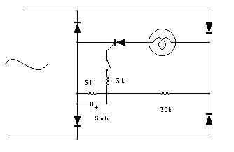

Hi batman, Sebi,
Heres a simple circuit with a switch on the SCR gate,
i imagine sebi would put forward a similar one.
The values are only guessed, i would start with them
and see how it goes.
I would be aiming for about 10 volts or a bit more on
the 5 mfd. It doesnt have to hold much, or for long, it
doesnt want to be so big as to cause a delay when switching
off. If it does make a small delay when switching off,
just reduce the value a bit till its ok.
Sebi, if you feel these values are within reason or
maybe too far out, please say so.
They are only guessed.
I imagine 3k would work the gate ok, they are pretty high
impedance, but some are lower than others.
30k at 120 volts sounds like about half a watt to me,
so that shouldnt get too hot.
Sebi ... comment ?
Regards, John :)

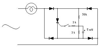

Hi batman,
So was it correct to assume that you want to switch the
light on and off, using an SCR ?
I am sorry to hear that you have damaged your SCR.
The gate is quite a sensitive connection.
Dont really see why you thought that would prevent the
anode voltage from going to zero.
Yes the circuit i have offered is incorrect, :oops:
although it should have done no damage.
Please accept my apologies, i have submitted another
circuit which should work satifactorily.
It was incorrect in that there would be very little
voltage across the SCR when conducting.
This next should be ok.
John

John,
no problem with Your circuits, cannot damage for SCR. But no need serial gate-resistor, and - avoid triggering when the switch is off - need a low-ohmic gate-cathode resistor (0.1....1k)
Thank you Ron, Thank you sebi,
Sebi, i have never had an SCR conduct with an open circuit gate,
but i suppose if it had lengths of wire over to a switch, then
yes i can see that a spurious spike could easily trigger the SCR,
so i have to agree, a resistor between cathode and gate would be
a wise inclusion to make sure it stays off when its supposed to.
Without the series resistor, you would effectively be discharging
the capacitor using the gate, which may be alright, but i am a
bit wary of damage, i have always thought the gate to be a bit
sensitive.
