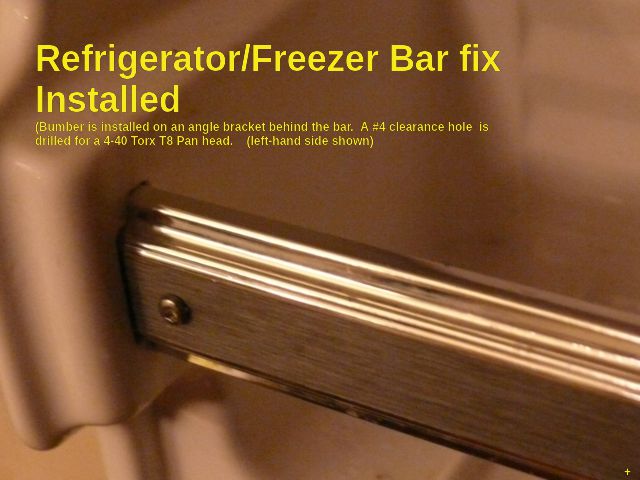

Here's a pic of a Torx Pan (not a security screw) head (#4 which is close to 4 mm) that I just did.

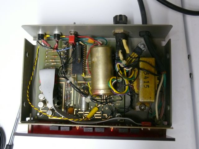

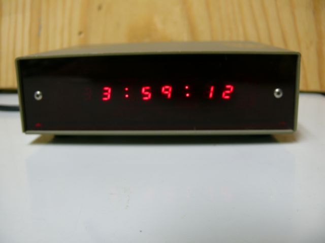

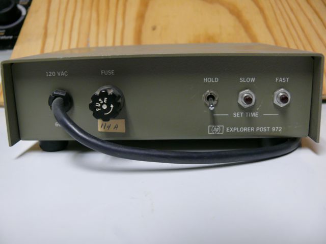

P1030046 (Clock Front view ( 640 x 480).jpg P1030048 (Clock rear View).jpg P1030055 (Clock inside view).jpg
Hey Throbs:
This was a clock I made as team of 3 at Hewlett-Packard. Our team given the components already placed had to tape the
PCB at 4x. Our group had the second clock assembled and the first one working. Besides a batch of defective components, there was only one problem. A small trace on the display fell off somewhere.
In any event the bezel uses two exposed Pozidrive screws on the front. The sides have two screws each to fasten the top.
The clock used the National MM5311
https://www.google.com/url?sa=t&rct...Uptf9QEC1FeL7WTEMjWB_w&bvm=bv.117868183,d.eWE chip.
