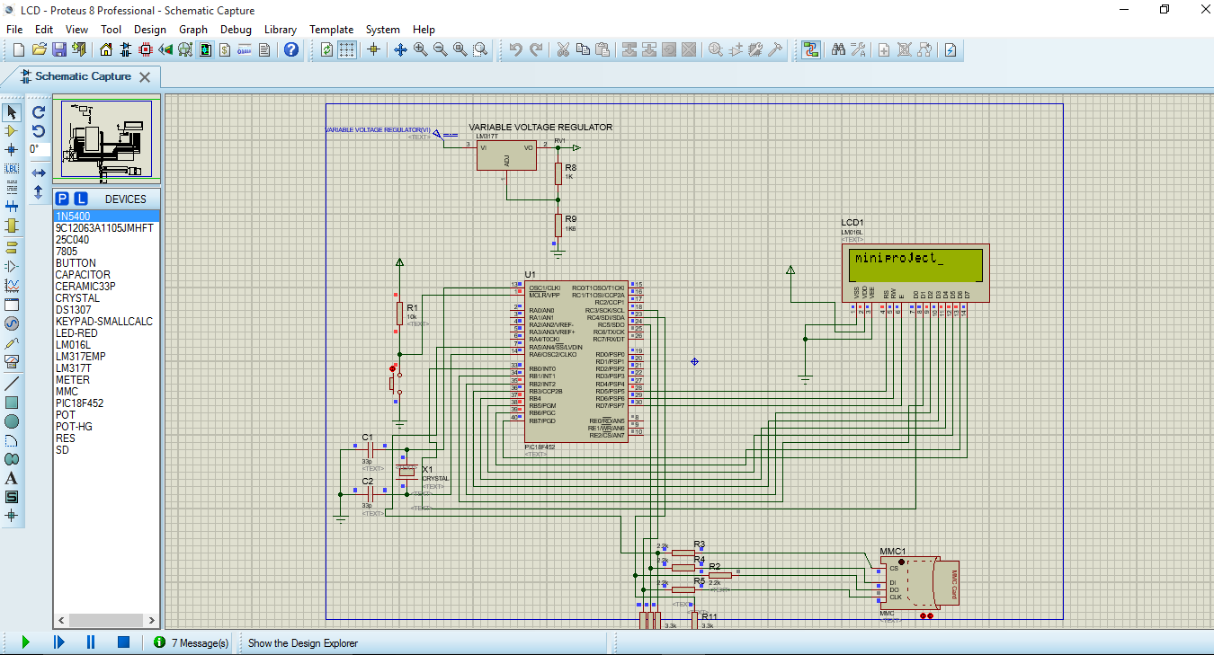

hello, i've been trying to interface SD card with pic18f452 and display the text files on it on sd card.
i've written a code in MikroC the code is as follows :

/* if(!Mmc_Fat_Init())
SPI1_Init_Advanced(_SPI_MASTER_OSC_DIV64, _SPI_DATA_SAMPLE_MIDDLE,_SPI_CLK_IDLE_LOW, _SPI_LOW_2_HIGH);
Init_SPI();
Mmc_Fat_Assign(&filename, 0);
Mmc_Fat_Reset(&size); // To read file, procedure returns size of file
for (i = 1; i <= size; i++)
Mmc_Fat_Read(&character);
Data(character);
however when i simulate it in proteus8 , the code runs till the if loop if the part after if is comented. if not, the microcontroller pins all turn grey colour (neither high nor low) can you please help?
ohh..ok. Is there a place where i can find example. because the ones i downloaded wont work either. also, is there a way to write it in mplab? i read about the petit fatfs library, but i don't know how to use it. can you please help?
