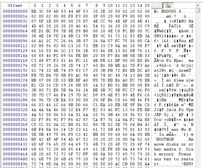

I have a SPI+18F2550+SDCard project written in C18 and I am having a problem reading sector 0 of my SD Card.
After the usual CMD0 (returns 1) and CMD1 (returns 0) I issue a CMD17.
At first, a look at the buffer (attached) looks as if it has done nothing, but at the end of the buffer the last two hex values are 0x55AA.
I understand that those bytes reside at the end of the MBR which is at Sector 0.
So it (sort of) works, but when I fire up Winhex to look at Sector 0 there is slightly more data (non zero) on the sector.
So it looks like my CMD17 isnt retrieving the data correctly, I have been able to issue SEND_CID and SEND_CSD commands with no trouble.
Any ideas? I am happy to submit my source, I just wanted to see if there was something obvious you guys thought I was missing?

Hi Futz,
Thats the problem, thats the image after formatting - take a look at the screen shot.
Your output format is bogus. The offsets on the left should be in hex, just like the sector byte values. Displaying that in decimal forces me to use a calculator for everything. Horrible! :p
Anyhoo, your first partition entry should start at $1be (446). It's not there. Stick that card in your camera and format it. What did you use to format it before?

Hi Futz,
The textfile is in 3 columns the first column is in hex (beginning at 0x100 so you need to subtract) then you get the decimal column.
I used XP to format the drive and it is 1GB.
I am sort of confused as i was expecting to see the same values in the text file that are present in the screen shot.
Thanks for looking.
Mark
p.s. using the information you supplied - $2be (remember the 0x100 offset) does have some data in it, see below.
Huh? You're confused?! I'm lost! Why wouldn't they be the same? The screen shot looks like a normal unformatted MBR, though probably previously used. But the text values make more sense.

That looks pretty correct. That's not all of it, but that first part looks right. Why doesn't your screen shot match? Maybe you're looking at a different drive?

D'oh, Silly me!
Actually Winhex was looking at the logical drives sector 0 and not the physical drives sector 0.
Thanks for taking the time.
