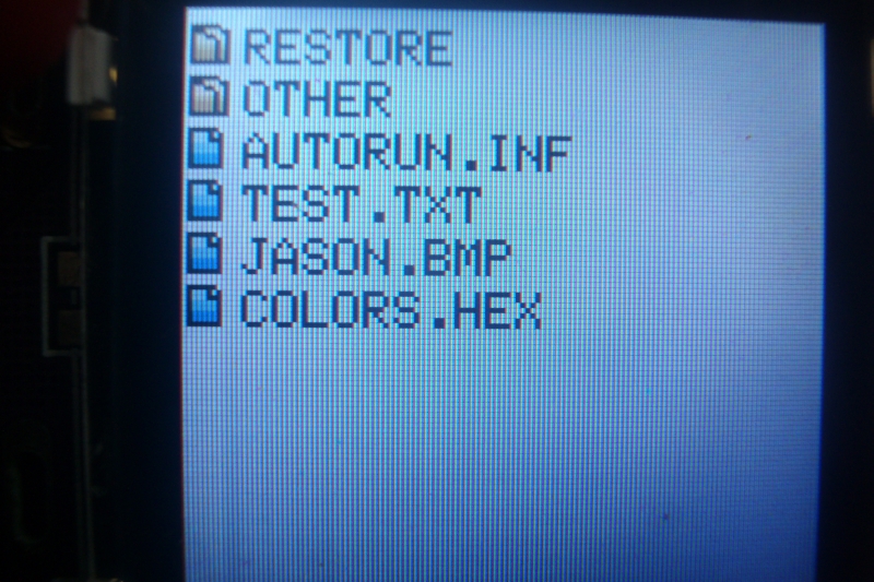

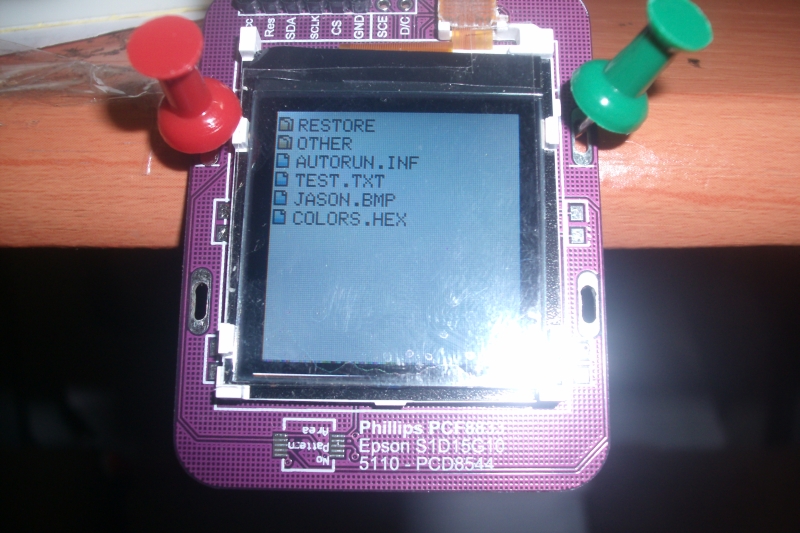

On his site is code to list directories and files:
my Altered version to show icon and file name;
FRESULT scan_files (char* path)
    FRESULT res;
    FILINFO fno;
    DIR dir;

I altered the scan file a bit. This way i can scan files or directories separate. I tried to incorporate like based on type but its hard heh. I can get the type of each but comparing is giving me a headache... The code below will list either directories or files and place them on my LCD at top/left with a image first.
You can do simple addition to find out positions but since i know what files i had and wanted to see how it look i ran this
    lsdir('/','d',5,5);
    lsdir('/','f',25,5);
This listed directories then files.

Here are some pictures:

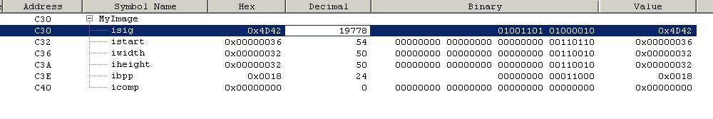

Im actually working on opening a BMP straight off the SD card without first converting it. Seems like a tricky thing....
Gota read header pixel data... heh its gonna be a nice feat to accomplish tho.
your welcome and happy holidays also:
Here is what i got so far header wise. The data can be obtained easy....
