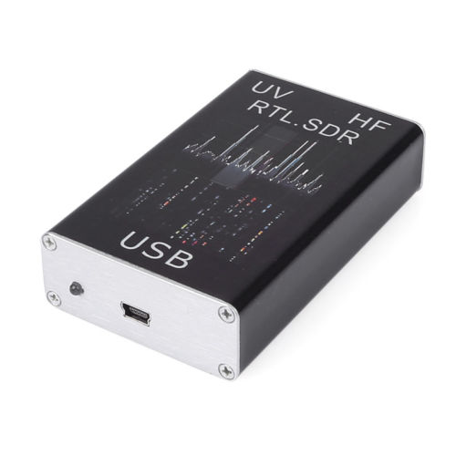

Does anyone else have one of these?, what do you think to it.
I built the kit bversion, the one without the upconverter, hf is directly sampled.
Apart from the tiny little wires soldered to the chip it went together fairly well.
It seems to work down to vlf and up into uhf reasonably well.
Certainly for the price of a takeout its not bad at all.

Sorry yes Sdr is a software package not a piece of hardware.
I meant the generic usb black box receiver available from china.
The kit is a pcb with some comps, and a usb dongle you take to bits and insert the pcb from it into the pcb for the receiver.

As far as I can tell they all use the same rtl dongle, the kit I got came with a dongle, I had to extract its pcb and insert it into the pcb that came with the kit.
Yes the batter ones have an improved front end, and usually a tcxo.
For a noob though these are pretty good, also handy as a piece of test gear.
Mine works down to 100kc according to its blurb, but I can get Vlf sub transmitters on 35kc no problem.
Seems to be processing power hungry, I spose thats the idea of the original dongle, lob as much of the signal handling over to the processor to keep hardware simplicity high and cost low.
