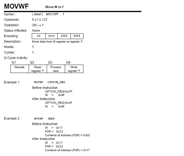

question: does the tutorial teach the usage of a command, like movwf (is this a command)?

hhyong99 said:
haha, Jay, you are really god...
I'll teach you something better. It's called reading the datasheets. Try interpreting what the datasheet says for movwf.

checkmate said:
That's what I am talking about!
