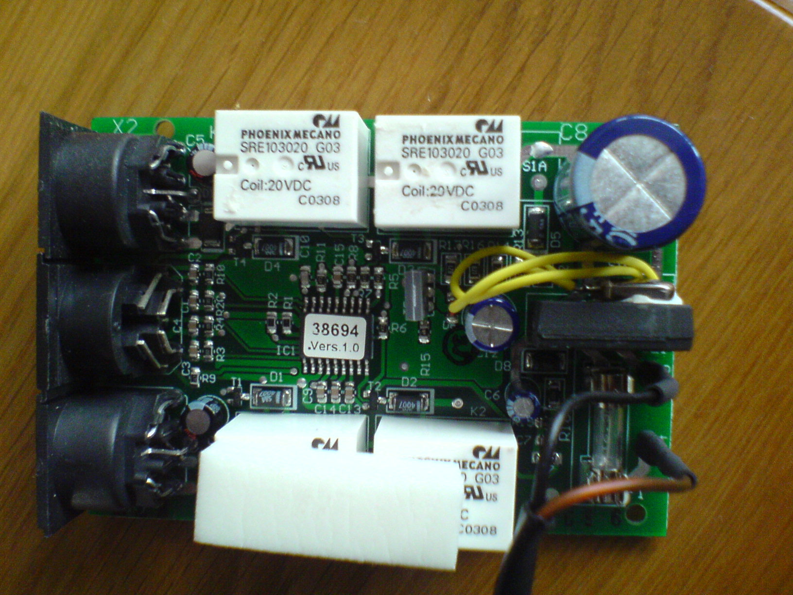

Does your relay assembly look like this (from this ETO post):
dsc01537-jpg.41669
If so, are you sure that it's one of the relays (labeled "SRE103020 G03") that has failed? What about the fuse (lower right on image above)?
What can you tell us of the current state of the entire assembly, i.e., are any of the relays working?

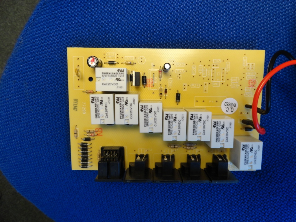

Hi Bob, I think that Board is from a chair assembly. The type we are dealing with are from profiling beds but they use the same relays. As you can see the relay is repeated several times and each one operates an actuator. It seems straightforward enough to diagnose the faulty relay but trying to source them is a headache as the bed supplier will not supply a component and we could do with sourcing a hundred or more for future use. Thanks Derek

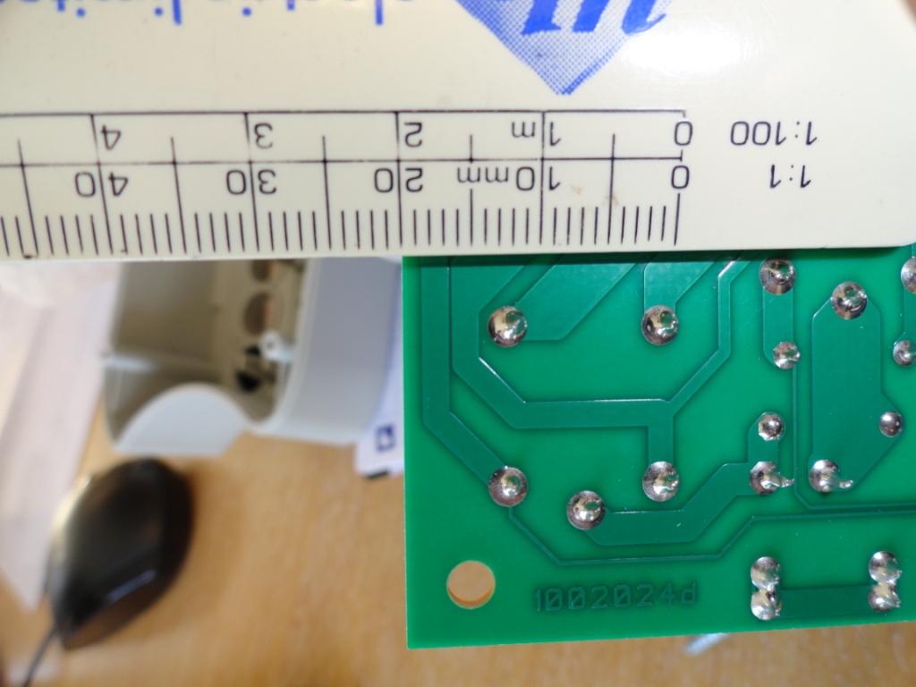

Is there any chance you could remove one of the relays and post photos of all six sides, especially the bottom with a ruler laid alongside so that the footprint and pin layout position dimensions can be determined? Relay configuration (SPST, SPDT, etc.) can, usually, be determined by the number of pins, coil pins with an ohmmeter and NO or NC status likewise.
Hi All, please see footprint of end relay. A 5 pin base, hope this helps and thanks for your advise on using a 24v coil.

Those motors in the profiling beds are gear reduction, thus in thought a relay with 30 Volt contact should work. As many relays are shown each motor has its own driving relay, I doubt that 1 relay is driving more than 1 motor at a time, via the no 2 motors are alike terminology in speed of rotation. (2 motors on 1 gear have been bad results for me in the past). One ran faster than the other.
Unknowns, what are the motors current requirement? (for a better rated relay)
The information i have from the motor (actuator) plate is 24vdc, Max 2.00A, push force 2000N. Does this help?

Footprint + pin placement dimensions:
Datasheet.
Of course, don't know if quiescent (OFF) NC - NO pin outs will will be correct for the PCB trace connections.
