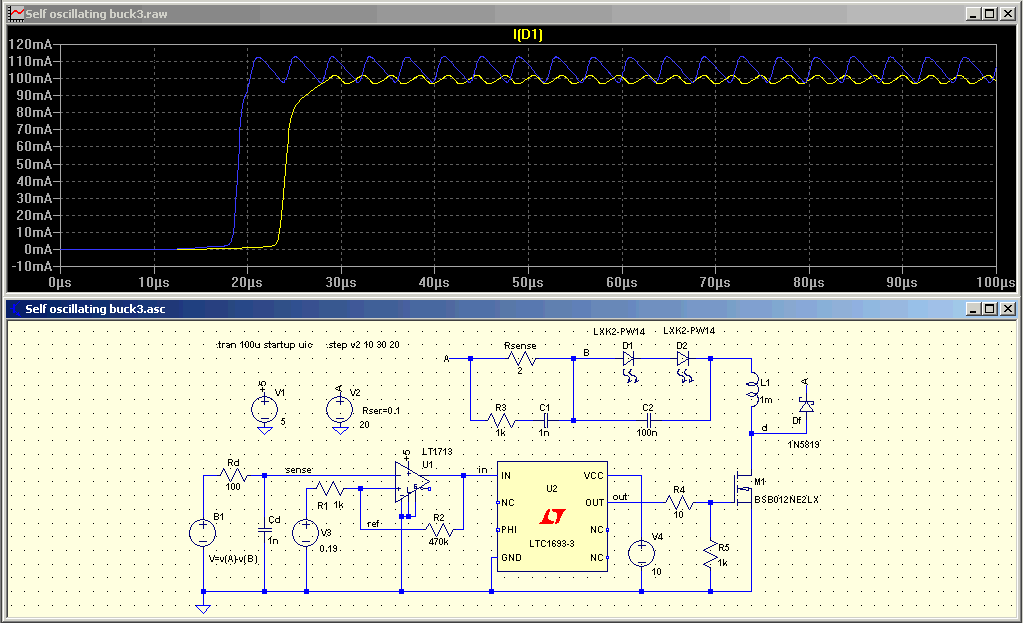

Hello,
I have here a simulation (LTspice) of a self oscillating Buck LED driver. It just regulates the LED current by switching ON/OFF its FET when the inductor current hits the requisite peak and trough levels. One comparator acts on the peak of the inductor current, the other, on the trough. (there is a resistive inductor current sensor)
The 'glue' logic that I have is a bit messy, (basically it just allows one comparator to disable the other comparator when it trips, to allow proper operation).
Do you know how I can use say NAND latchs in order to tidy up this circuit?
LTspice simulation and schematic attached..

Couldn't you just replace the two comparators by a single comparator with hysteresis?
yes but the led current regulation would then not be so accurate over line and load voltage changes.

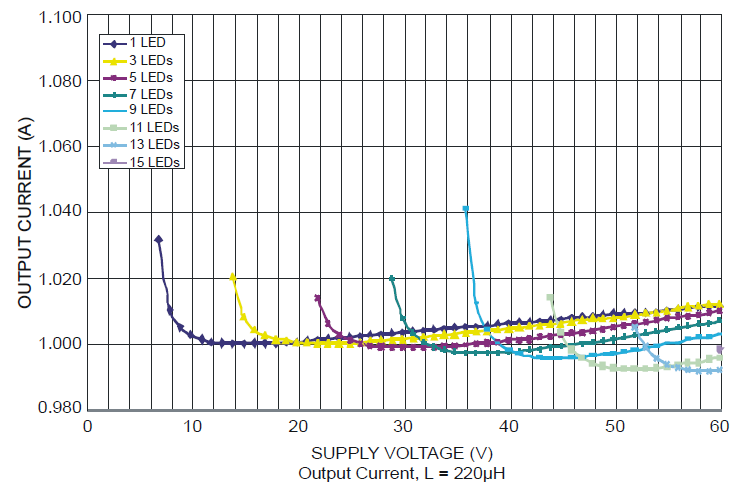

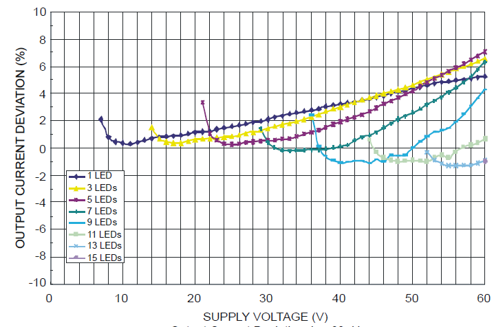

For 1 LED; 7 volts to 30 volts the regulation is 2%. To 50 volts 4%. How good do you need?

When running your sim I see both comparators tripping at the same point, corresponding to the current trough?? Peak current is being limited by the inductor rather than being set by either comparator.
Here's a sim of a hysteretic single-comparator simplification of your circuit. LED current variation is ~4% for a 3:1 variation in supply voltage, and less than that for a load change from 1 to 2 LEDs. Rd and Cd allow the frequency to be reduced (if required).

Alec_t......thanks for the sim, i enjoyed that, I had not previously known how to do stepped comparisons like that...im storing that one away where I can find it again, very useful.
Though Alec_t,i used your sim sometimes with just one led,and sometimes with three, and with the 10 to 30v input range, and got an overall 10% max difference. Remember that these buck converter led driversa re likely to appear in multiples in a singleproduct, andbe supplied by an upstream offline power supply.....if every buck is supplying 10% more than it should, then the offline psu is going to overheat, or need its components to be too high rated, ie, higher rated thannecessary.

Isn't that worse than the 10% variation you found with my sim??

I'm sure they have, but it's not unknown for manufacturers/designers to omit vital details, or add spurious details, in published schematics to obfuscate the real circuit as an antitheft/anti-piracy measure. Of course, I'm not saying Diodes.com would do such a thing :). Since both comparators trip at virtually the same point in your sim, perhaps one is a belt-and-braces backup to ensure the FET switches off at some safe point? I don't see why you/Diodes.com have R12 and R13 shorted together? That places R2 and R3 in parallel.
I see what you mean about those resistors, I think I just got it working and that was it, i left it, I have been trying to do it properly with memory logic bat haven't succeeded yet.
Did you get the comparators to trip at current peak and trough respectively? Personally, I don't see the trough trip level being as critical as the peak trip level ....providing the FET switches on and off. The less the gap between the two levels, the higher the switching frequency and the lower the LED current ripple amplitude.
You've 'cheated' by using a behavioural voltage source to get the current-sense voltage V(A)-V(B) ;). Since V(A) and V(B) are both at/near the 20V supply rail, how will you actually get them into comparators running from the 5V rail?

Yes I used behavioural volt source, but to be honest, its just a representative simulation so that the students can see how its working...I mean, we have the zxld1366 hardware working, its just that the students can only be in the lab when supervised, other-times they only have the simulator -hence we need something to represent the zxld1366 in the simulator.
