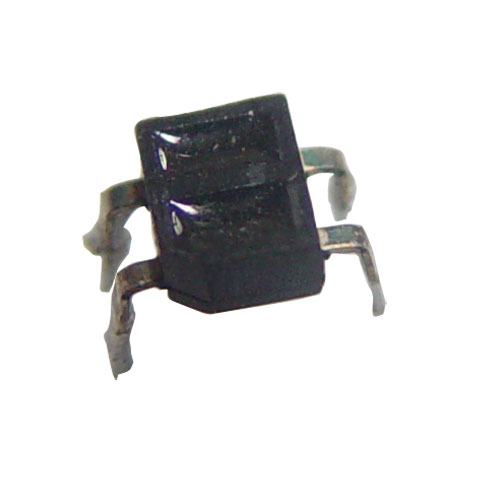

you can use something that like attached file to detect the line and parking spot.
from where do you read, that it's an detector?!? I'd say it's more emitter than detector any time...
also pay close attention to the wavelengths of those things. they must match.
I just found another pair, but it dosen't list the wavelength for the detector, just a range of wavelength.
