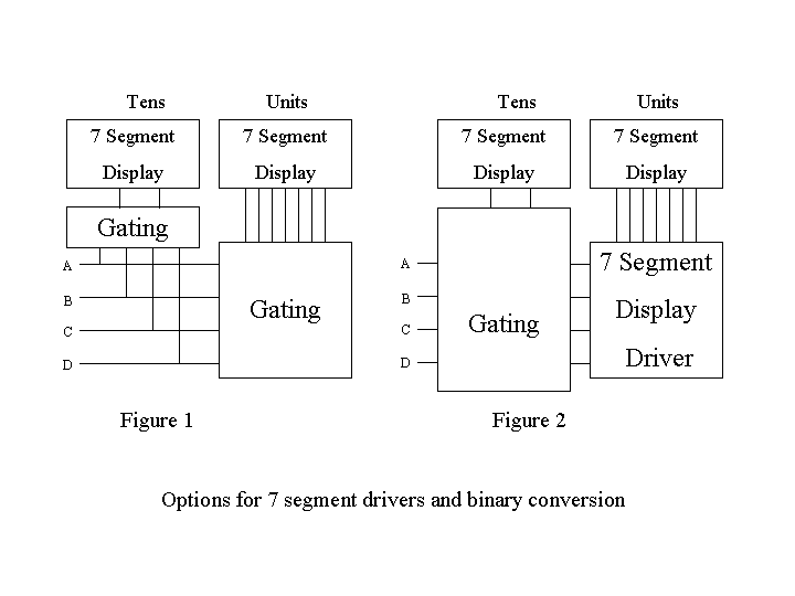

I only have to deal with the BCD 8421 Outputs from his build...Inputs into my build for display in a 2-bit 7-seg. So far I can get it to show 10 and upto binary 1111 as expected, but I need to some how shift it so I can read 1,2,3,4,5,6,7,8,9,10,11,12,13,14,15....The first digit has to recirculate some how so I can get it to read 1 on a binary 1011, 2 on a binary 1100, and so on. Would a demultiplexer work???then re-encode it ???

Basically I only need to decode BCD 8421 to show 1 through 15 on a 7-seg display.
Digit MSD,LSD 2 bit decimal. This is what I need the display to show. A full 8-bit binary count.

Your latest post is hard to understand. I assume you want to know how to display a 4 bit binary number on two 7 segment displays so that, for example, 0101 is shown as 05 (or perhaps just 5) and 1100 is displayed as 12.
To do this, you need to subtract 1010 (decimal 10) from the binary number if it is > 9. This will give you the units digit in BCD and the 1 for the tens digit is simply the output of the comparitor that detects whether the number is > 9 or not.
If the number is <10, then you subtract 0.

I assume you connect 0 to the 0 to 9 inputs of the 74150 and 1 to the rest. This seems a clumsy way to do it, but will work.
As an alternative to what I suggested earlier, I would be inclined to use a magnitude comparitor to determine whether the digit is >9 or not. If greater than 9, add 0110 (decimal 6) to the number and ignore the overflow. If <10, add 0000 to the number.

The use of either a Multiplexer or a Comparitor is an over kill.
It can be done with a single NAND or NOR gate package as below.
The Boolean funcion is D.B + D.C = D.(B + C).
The option are drawn below.

I don't understand this post. I assume you wenat to convert binary into BCD so it can be displayed on two 7 segment displays. The simplest way I know of is to use an adder as I suggested in an earlier post.
If the number is > 9, add 6 to the binary number to obtain the correct units BCD digit.

I have drawn 2 options below. Is this what you want?
If so, which option do you prefer? The "gating" is simply combinational logic composed of NAND and/or NOR gates.
Do you know about Karnaugh maps?
