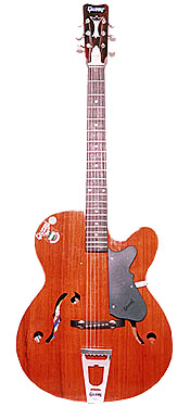

I'll post the image of my guitar so that you can tell me what to do.
It does not have an inbuilt pickup or any other feature.Just a guitar cable that can connected to an amplifier.

We still don't know what you've actually got, or if it even works - have you tried plugging it directly into a normal guitar amp?, if so what did you get?.
