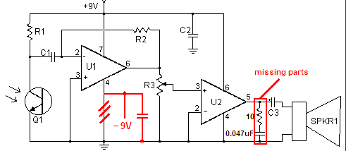

You should know the laser receiver circuit doesn't work just by looking at it:
1) Its opamp has its (+) input connected to its negative supply pin so it is incorrectly biased and won't work. Adding a negative supply will simply fix it but adding two resistors to bias it at half the supply voltage and adding an output coupling capacitor will also fix it.
2) The opamp is inverting which has a very low input impedance. Then it has hardly any voltage gain. Using the opamp as a non-inverting amplifier that has a high input impedance with lots of gain and biased properly would fix it.
3) The LM386 power amp is missing important parts.

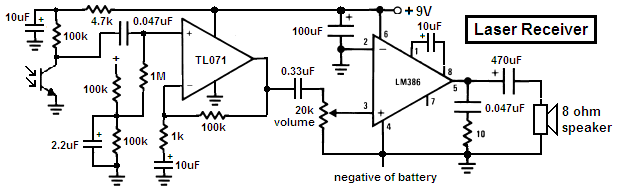

wooooooo.. i don't underestod... please anybody can post de full diagram ???
The laser receiver should have been designed like this:

Thanks Audioguro!!! of that way migth work??
It will probably work but it might be too sensitive. The sensitivity is 1/10th if the 10uF capacitor is removed from pin 1 and pin 8 of the LM386.
I would never make a simple Laser communicator:
1) The laser beam must point exactly at the receiver. If you bump it then it might move a little then it doesn't work.
2) It is ordinary analog transmission which picks up interference from AC powered lights and many other lights.
3) It is mono, not stereo.
