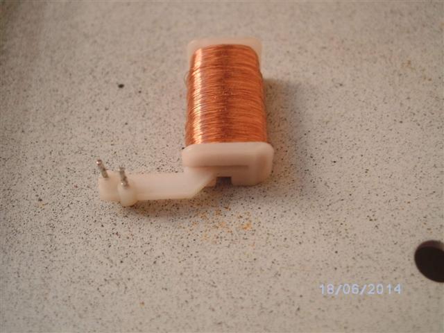

I expected to sense a magnet in motion passing close to this coil (from a discarded relay), with the scope in the lowest scale (2mV/div) but no joy.
In case you ask, continuity is OK and magnets were moved in any position and in any sense you could imagine wrt the coil.
I tested all the magnets in my drawers. While I know that no one is made of Neodymium and the diameter of the coil is really small, I expected a minimal output at least.
What could I be doing wrong?

Maybe the coil is short circuit, rather than countinuous - around 270 ohms measured.
Maybe the scope was not set correctly - 2 mV - DC
may be you set the sensitivity on channel A and the probe was connected to channel B - yellow probe in the yellow channel triggered by the yellow channel.
maybe the probe was not making good contact with the connector pins on the coil. -

Solved Jim.
Found a magnet that is giving up to 10 mV and 20 mV with a core inserted (take from another relay).
Gracias again.
So, just not enough magnetic flux to give enough induced volts to see on the scope.
Definitely something I took for granted but never tested or thought about in detail.

Just out of curiosity are you using DC or AC coupling on the vertical input to your scope? I would think DC coupling would show the best response depending on how quickly the mgney is passing the coil. Also try a few different angles.
Ron
DC, Ron.
But after thinking of all what I did today, I suspect that I am not moving the magnet fast enough. Tomorrow I will do a more consistent testing, even with the not so powerful magnets.
Most Important was Putting in that Core.
It (Amplifies) Concentrates the Lines of Flux.

Sensing a magnetic field is all about speed, distance, field strength, and orientation.
The faster the magnet moves the higher the output voltage from the coil (not the same with a Hall Effect Sensor).
The closer the magnet is to the coil the higher the output voltage.
The stronger the field strength the higher the output voltage.
The better the orientation of the magnet to the coil the higher the output voltage.
