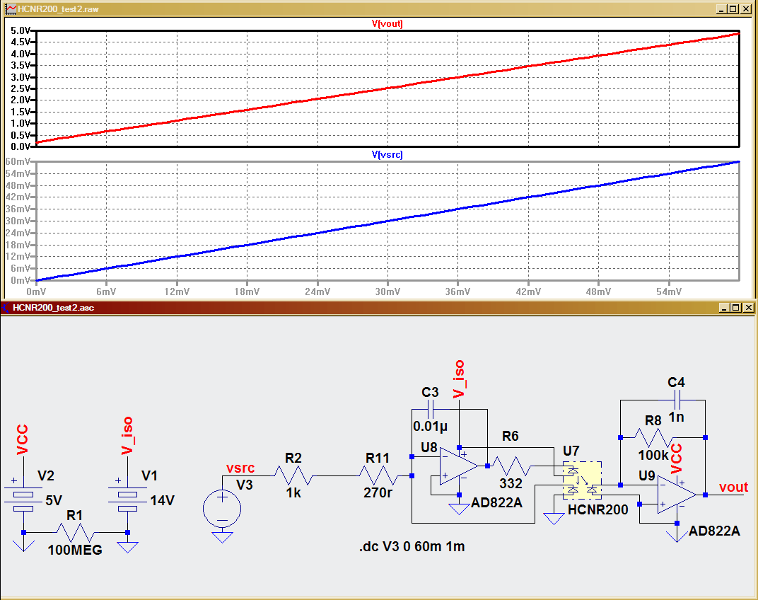

what i had done is that i had converted input voltage of a single device to pwm pulses and passed through an opto(mct2e) after that i had averaged the signal by a filter but the problem is the output is not linear, also my input is variable from 12v to 40v. i want as the voltage changes the output should also vary and the measurement should be precise.
There is this linear opto. HCNR200

EDIT:
This is circuit drawn for an OP, it worked fine.
  • HCNR200.pdf
    HCNR200.pdf
I have used reed switches in scanners, simple to to drive and suitable for analog or digital signals.
EDIT:
