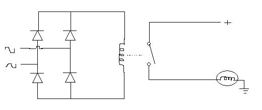

I am wondering if there is a solid state relay with low voltage AC input (output will switch DC). Presently the motorcycle has a single phase AC stator and uses AC for the lighting. It is equipped with a battery for electric starting. The full AC output is regulated to about 13.5 volts and a small portion is rectified for battery charging.
I like the fact that when the engine stops the lights go out. No fiddling with a key or switch to turn off lighting loads every time I stop on the trail. The LEDs in the tail light are able to run on AC with a bit of flickering. This is OK.
If I want to run the tail light on DC, but have it lit only when the engine is running, I need a relay that works on 12VAC. I called OMRON to learn that their lowest input solid state relay only goes down to 24VAC with a 15VAC minimum threshold.
I can get a mechanical relay with a 12VAC coil, but it is designed for 50 to 60 HZ operation. Since the bike can rev to 10,000 RPM I expect the frequency will exceed the capabilities of the relay coil and cause it to overheat. The fact that it pulls in at 7V and drops out at 1V is fine.
I plan to increase the headlight bulb to a higher wattage which will pull down the AC voltage at idle. This voltage drop will also reduce power to the LED tail light. I prefer to have the tail light operate at a normal brightness, so I would like to change the tail light to DC operation, but use AC to trigger a relay. The relay would then connect the tail light to the battery only when the engine runs.
Hope this is not too confusing.
Any suggestions?
You could use a DC coil, together with a bridge rectifier, as shown (yes, you will lose two diode drops):
Else, you could connect the relay coil to the ignition circuit, so it activates with the ignition on (and connect the relay contact in series with the lamp. But you knew that, I'm sure :) )

I hadn't thought about rectifying first. Good idea, thanks.
There is no ignition switch on the bike and I prefer it that way (just have to keep my eye on the bike so someone doesn't hop on and ride away).

Why not just feed the LED tail light from the alternator via a bridge rectifier. Fit a reervoir cap if the flickering bothers you.
