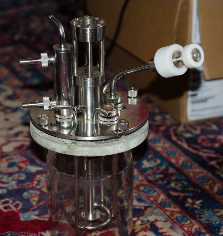

I might mess with this a bit, I can see no real use for met at the moment but its a good excuse to dust off the soldering iron and put this away for a while
