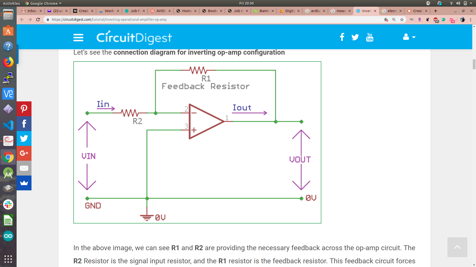

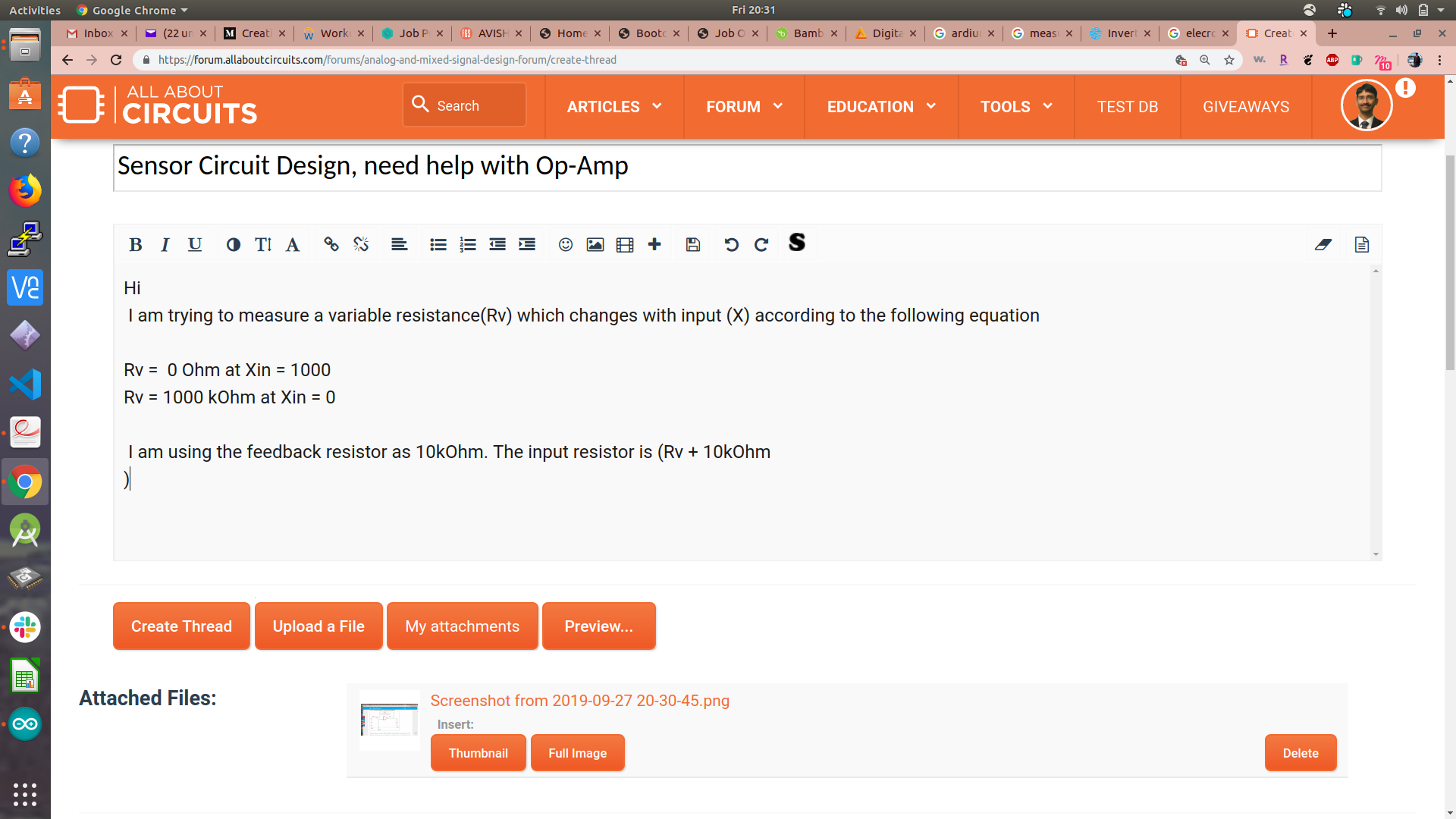

Thanks for correcting me.
Sorry wrong schematic attached
Best
Chandra

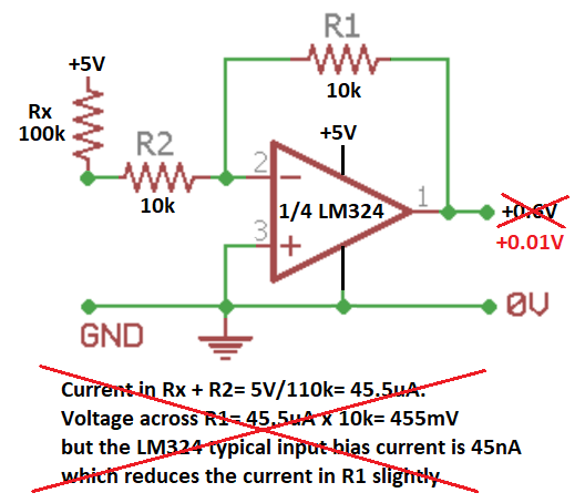

Check the input common mode voltage range and the output voltage range on the LM358 datasheet. Your feedback loop might not be closing. It is common for simulation programs to get this wrong.
ak
Your schematic shows missing resistor values, missing the opamp part number and missing a power supply for the opamp.
I corrected your schematic and guessed where Rx is. The output is not +0.6V.
EDIT: The opamp does not have a negative supply and is trying to drive its output to a negative voltage but it can't. Then the output will be about +0.01V as shown on its datasheet.
