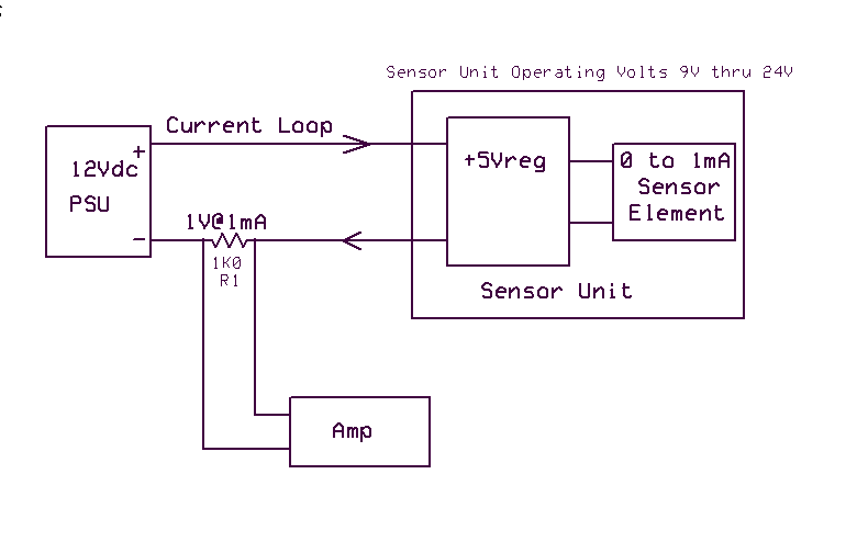

While Willbe is doing his schematic I'll try to explain the overhead voltage bit.:)
Assume your 1mA source was derived from a voltage source of 10volts.
If we connected in the 1mA loop say a 1000R resistor we would measure 1Volt across the resistor
when a current of 1mA was flowing in the loop.
This could be amplfied to the output voltage you required.
A problem could arise at the sensor source due to the added 1000R resistor reducing the voltage
across the sensor to only 9volts.
If however the sensor required only 5volts to operate correctly, it would still have a 4volt 'overhead' to drive the 1mA loop.
This is the way that a 4mA to 20mA loops works.
The sensor will work OK with a supply voltage of say 12V and drive 4 to 20mA thru the loop.
If we power the sensor with say 24V, that leaves a 12V overhead so that we can add resistors in series with loop in order to generate an output voltage that we can use.
Hope you follow OK.

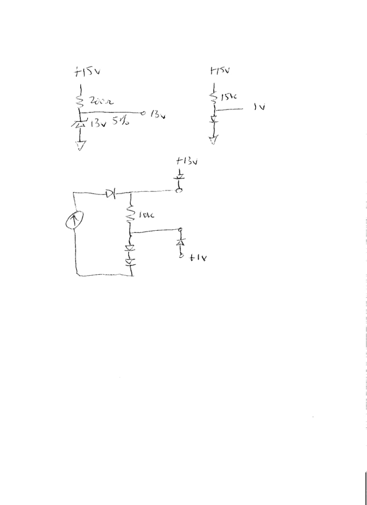

I put it in my album called Tech. See if you can retrieve & post it. If so it was my mistake; I had the photo as a folder and not as a pic.

hi Andy,
Perhaps this dwg will help.
The Voltage connected to the two wires in this example is 12Vdc.
The Sensor Unit has an inbuilt 5Vreg.
The reg reduces the voltage to the sensor head electronics to +5Vdc
The 1mA flowing in the loop develops 1Volt across the 1000R.
These leaves only 11V to the input of the sensor unit 5V reg, but as the reg will work down to say 7V
[that is the 5V reg requires at least 2V more in than out, to work correctly]
If I we now fitted a 10,000R in place of the 1000R, we would loose 10V across the 10,000R and the sensor unit would be 'starved' of voltage and would not work correctly.
So this means in practice we are only allowed to drop 5V across the current sense resistor ie: so a 5000R would be the maximum allowed.
We could of course use a 24Vdc PSU and the 10,000R would be acceptable.
Is this any better.?:)

That circuit doesn't look much like what I wrote.
:confused:
The bottom of the current source should be grounded.
Secondly, the two diodes in series pointing down are supposed to be a 2 V reference voltage.
If you're going to build this thing I'd substitute a "programmable shunt regulator" that goes down to 2 V . Some versions of the LM431 go that low.
The LM10 is another way to do this.
I need to get a thicker pencil.

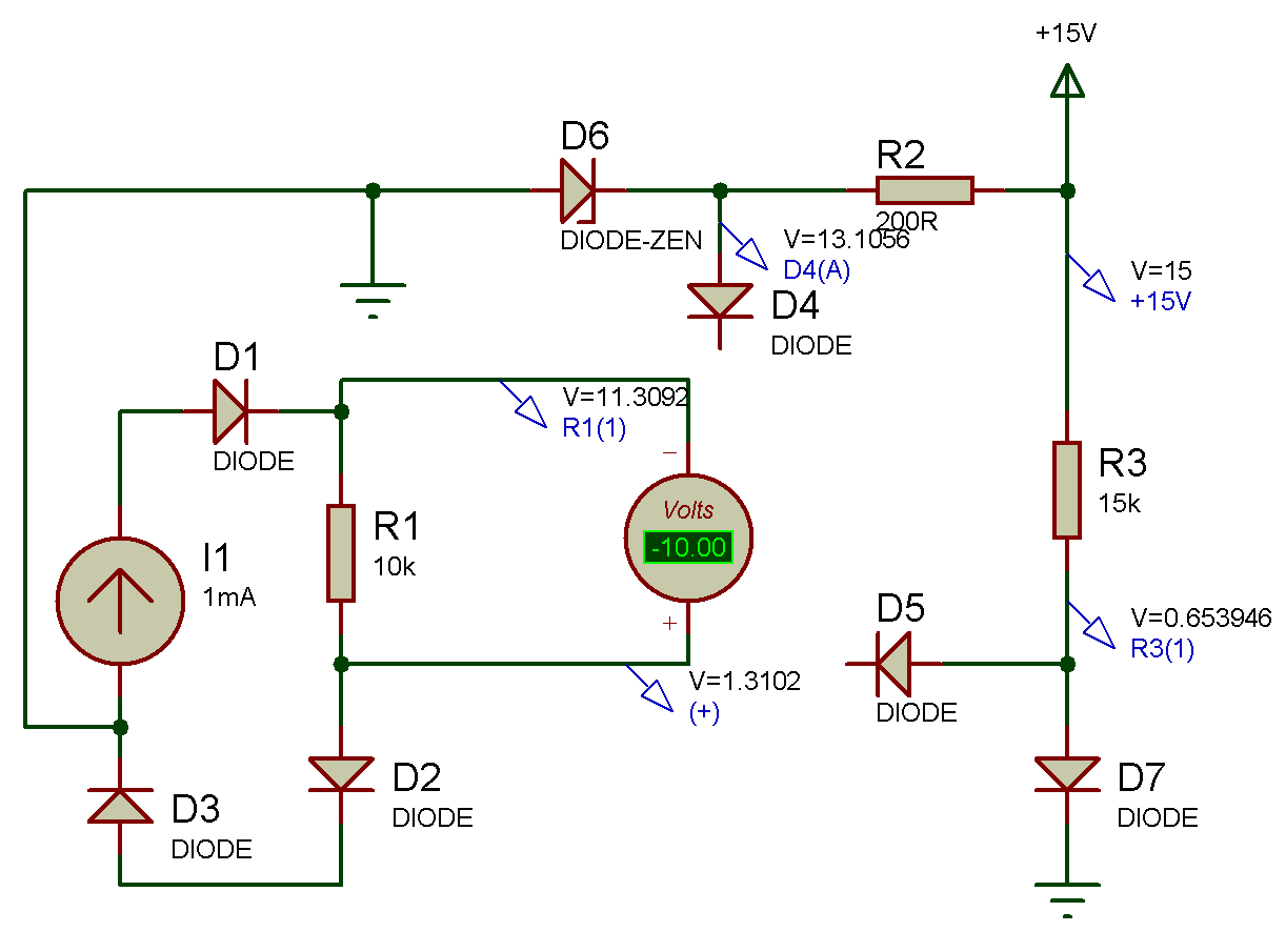

Willbe, please find attached circuit schematic as taken from the simulator, I left the +13V and +1V sources not connected with the voltmeter for now. I think I got confused which is the entry point of the 2V shift to the circuit. Simulating the circuit with only the 1mA source, diode, 10K resistor and 2 diodes in series then ground, gets the voltage across the resistor to be the required 10V, however, as I understood from the 2 upper schematics in your diagram, that these are the voltage shifter and would fit in with the voltage across the 10K resistor to produce the required 2 to 12V, please correct me if I am wrong. Not sure what do you mean by the diodes being 2V ref voltage. I do apologise for being pain in the backside, I am still fairly new at this and trying to get my head round many things. :) Thanks
The two upper schematics are voltage sources that can sink current for the protection diodes so that the 2-12 V doesn't ever go outside that range.
The upper 10 K output pin can't go above 13 + 1 = 14 V and the lower one can't go below 1 - 1 = 0 V.
Some voltage sources can only source current; driving current into them makes their output voltage higher. These two sources can sink and source current.
A forward biased conventional diode (like a 1N4148 or 1N4001) can act like a ~1 V Zener diode when you push rated current through them; that is, the V-I curve is almost horizontal [with V on the Y-axis and I on the X-axis] at around 1 V, but diodes used like this are not precise and are temperature sensitive.
So, two diodes in series at rated current approximates a 2 V Zener. This is what shifts the 0-10 V output into 2-12 V out.
You can see by your meter that silicon diode D7 is barely turned on, because ~14 V/15 kΩ = ~1 mA, and that's not enough current to turn it on fully. You can reduce the 15 KΩ resistor to get more current and a higher Vdrop across that diode.
D2 and D3 are also not fully turned on and that's why you got only 11.3 V instead of 12 V. You could increase their current to 10 mA by running a 1300 Ω resistor from the anode of D2 up to +15 V. I considered putting in this "keep alive" resistor but I left it out for the sake of simplicity.
Note that the Vdrop across a diode is due to the Vdrop across the PN junction plus a small drop across the diode "bulk resistance", this resistance resulting from the material they used to make the diode.
I should have labelled all these diodes D1, D2, etc.
The one on top of the current source (your computer calls this D1) prevents the 2 V diode drop from pushing current back into the source through the 10 KΩ resistor. 2 V/10 kΩ is 0.2 mA so this would introduce a (100%)*(0.2/1) = 20% error in the current source output.
This should explain the purpose of all the components.
Revision A: Change the 13 V Zener to 12 V; I just noticed this minute that when the output is at 12 V the protection diode D4 is turned on. Since it's not connected in your circuit, you didn't notice this effect.
