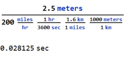

Hi, I'm no math guru but I would like to know this math puzzle.
Situation: A LASER on one side and a LASER sensor on the other side. If a car passes and breaks the LASER beam how long will it block the beam if lets say the car is 2.5meters long and running at around 200Mph.
Thank you!

Well, 0.008333 hour is 29.9988 sec and looks a little too long. Longer than a drag car could complete a 400 meter run.
Ratch
Hello Ratchit, thanks for helping. 0.028 sec sounds realistic enough. I was worried that a car too fast won't get detected, well we have none here that could go 200miph. Sensor threshold is around 0.0005 sec average.

(2.5m/300,000M/hr) X (3600sec/hr) = 0.03 sec
No matter what speed values and units the OP said or meant, the method I showed uses units cancellation to give traceable calculation results no matter how the distance or speed are described.
