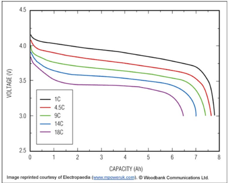

Again, as the resistance goes up any heavy load will drop the voltage. The cell itself has a much higher electrical voltage.
  • Battery Voltage LiIon.pdf
RCinFLA, can you site the source for that graph? I can't find anything to substantiate it, you can't determine state of charge of a Lithium cell from no load voltage from any source I've ever found. State of Charge has to be determined under load, and temperature of the pack is important. Typicaly Lithium Polymer SOC measurements use a Columb counter to determine state of charge.
The only battery chemistry I've ever heard no load voltage to be a reliable method to test state of charge is Lead Acid cells, and even that assumes that the chemistry has been 'at rest' for a lengthy period of time and the pack is at room temperature.

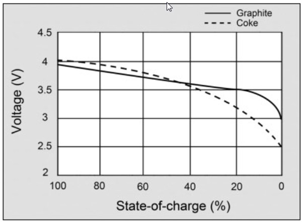

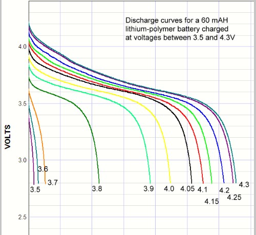

I hve seen end-of-charge voltages for Li-Ion anywhere from about 2.8 to 3.2V used. Look in the left curve below and notice that in the region of about 2.8V to 3.3V, the curve is going vertical. There is very little additional energy avaialable there.

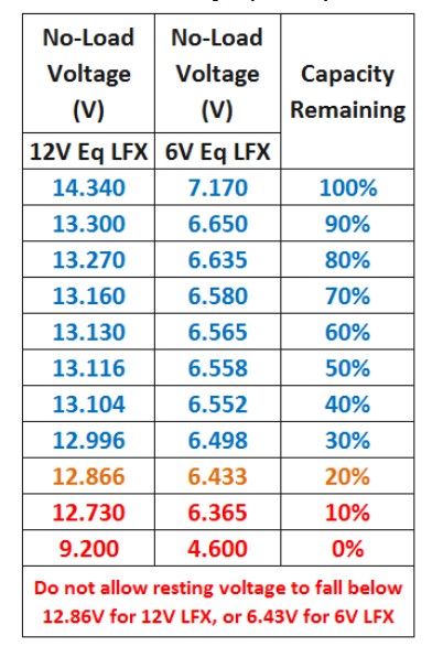

Here's the Shorai info for their Li batteries showing charge versus cell voltage.

Thoughs numbers are likely with some loading, probably a minimum processing idle with LCD backlight on a laptop.
