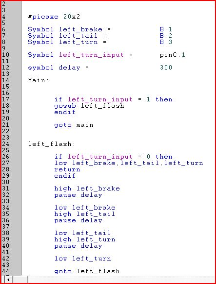

A simple example of code to control the flash sequence for the lefthand lights would be something like this below.
It will light each light for for 300 milliseconds then move to the next and do the same
The "if then" statement under "main" checks for the condition of the input pinC.1 for a high signal and if so then the program jumps to the sub routine called "left_flash", the "if then" statment in "left_flash" checks for the condition on pinC.1 again for a low signal and if so switches all the lights off and returns back to the "main" routine again.
If pinC.1 is high it will proceed to flash each light in sequence for 300 ms then go back to "left_flash" and check the condition of PinC.1 again and if still high then repeat the sequence again and so forth.
This just an example and there is more "if then " statements needed and more sub routines required to complete the full functions requested. (ie: brake lights etc.)

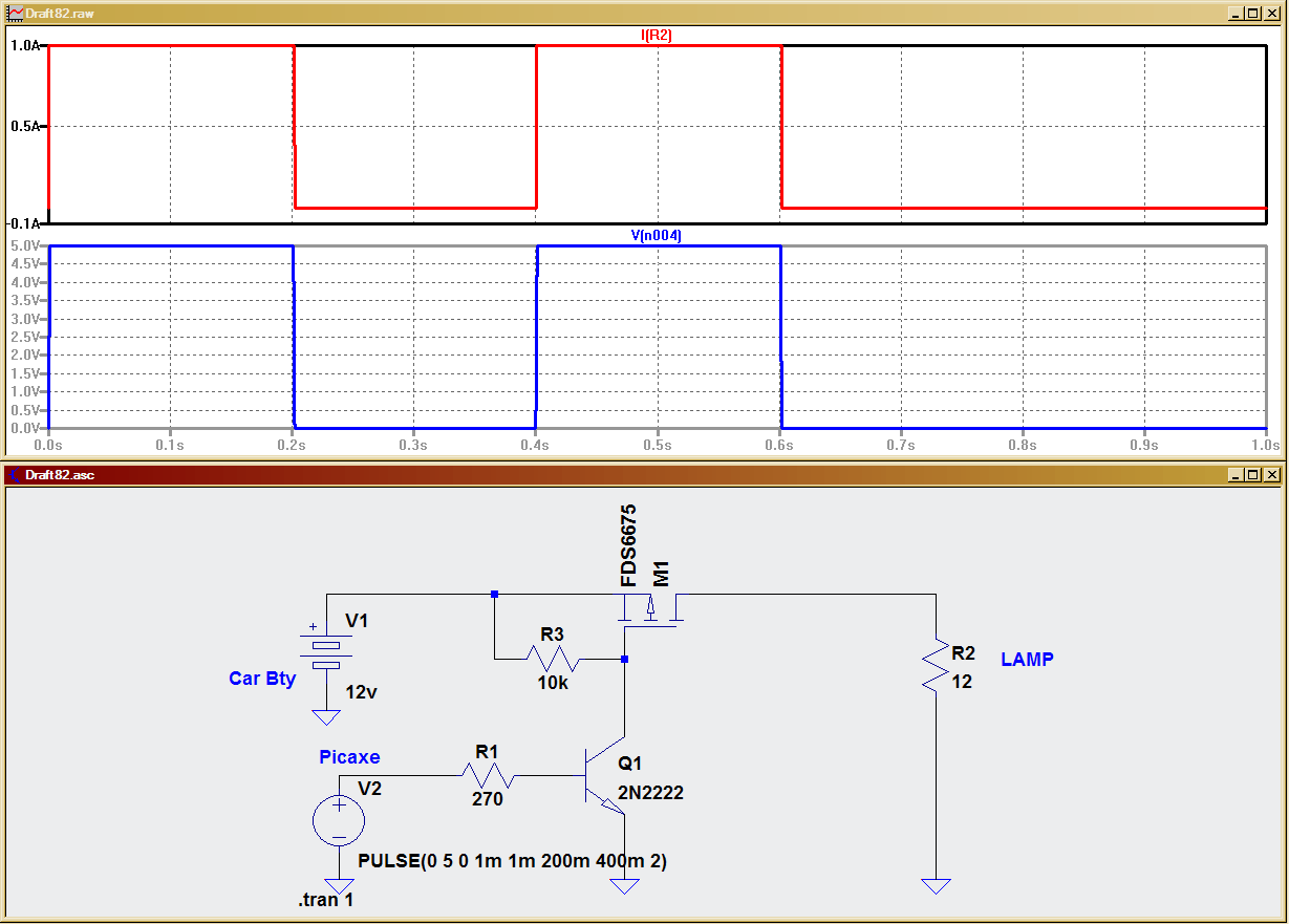

Hi Pete,
The usual way is a series resistor from the 5V pic pin to the base of a transistor and the load [ ie12V lamp] in the collector.
A MOS FET could be used in place of the transistor.
Would you like a circuit.?
EDIT:
Using a P MOSFET, its well over rated for the lamp surge

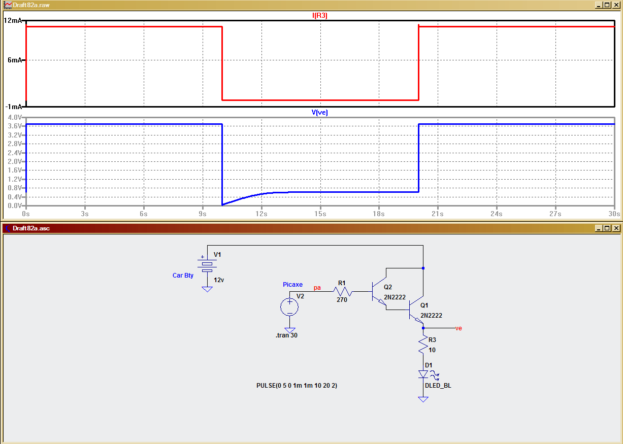

Pete,
Are you considering switching the low side of the lamp to chassis [0v].??
The BD681 has a high Vsat at around 1A to 2A collector current,of ~ 2.5V
Hi Eric,
I really dont know how the lights are set up and well expect they have a common earth to chassi.
If this is correct than it will be required to switch 12v+.
I was thinking collector to 12v+, emitter to led light, and a resistor between base and picaxe.
I also dont know how the leds are configured in each light but would expect only a supply of around 2 volts through the light, so i would expect the transistor to switch on fully as the base voltage (5v) is higher than the load voltage required.
Correct me if i am thinking wrong here.
Pete.
Hi Eric,
If this is the case, a high side switch will be required, [ as per the FET dwg]
The max voltage across the LED would be 5V-Vbe drop, if a darlington was used the Vbe would be ~ 1.4V, si if I follow your description correctly, all you would get across the led would be 3.6V
As its an emitter follower the BD transistor would not saturate.

I am not pushing the P MOS approach, but there are T220 pin types available for about 67Pence UK, see d/s.
EDIT:
Dwg, is this the way you meant.??
