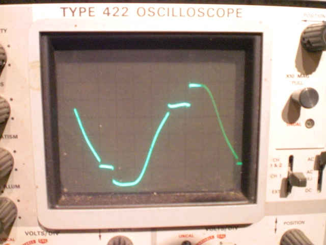

I have a MOC3011 optocoupler driving a 2N6073a triac full on. this is turning on a relay. Here is a picture of the scope.
As you can see not pure sine but not as bad as I remember either. I would still operate off relays.

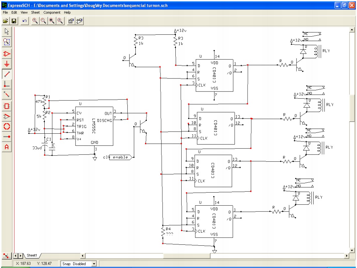

This is what I had in mind
I don't see how your circuit goes in sequence?? I am missing something??
the attached is just what I was thinking. needs lots of work - rest set pins, transistor resistors etc.
the 555 is configured to pulse every 1 second. when the count reaches X then disable the clock inputs and reset the D flip flops and all the relays shut off all at once (the Q outputs go low)
I know it looks unprofessional but its just a start.

mrdeb : the 555 has 1k extra resistance in the r/c circuit than the one above it adding a second (or so) before changing the output to low turning on the load (amp in my case). Theory is when my receiver is turned on.. the 12v trigger output through phototransistoer (right name?) sets things on motion and my amps will turn on sequentially. They should stay on until the 12v source goes away and ccurtis' addition drains the caps and they turn off. Thanks a lot for taking the time to offer an alternate (and probably better) design.. but this one is now working and i understand it!
