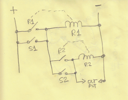

I have in the past come up with a circuit, using relays, that can take care of the situation where S1 and S2 are never present at the same time. Unfortunately, this other setup is driving me bonkers.
A relay circuit is shown first.
S1 and S2 are momentary contacts.
R1 and R2 are normally open relay contacts.
R1 and R2 are also the coils of said relays.
Press S1 first, then S2 second or Press S1 and S2 simultaneously and both relays latch. If you press S2 first and S1 second, nothing happens, except that S1 is latched, now the circuit is waiting for S2 to be pressed again.
Interrupting power resets the relays.

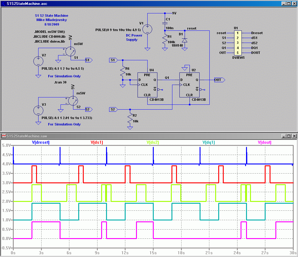

A dual D-flop version is shown below.
Begs the question of what happens if the rising edge of S2 is absolutely coincident with the rising edge of S1? As it is, depending on the logic family, S1 would have to preceed the rising edge of S2 by a few nsec.

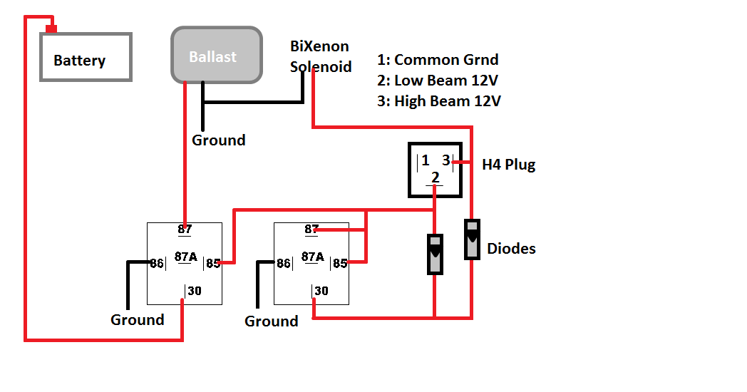

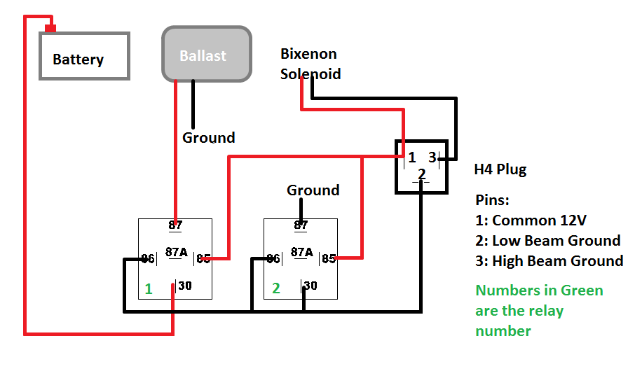

Hmmm, interesting. Is there any way to extend the required gap between s1 and s2? I guess to explain this better I should mention EXACTLY what it is going to be used for. It is an attempt to get around using a delay timer to knock-out the pass-to-flash feature in most cars. For people who are running HID's, flashing the HID's are bad for the ballast and REALLY bad for the bulb. While I have made a circuit that requires the low beam to be on first (for both positive and ground switched systems) in systems where either the low is on or the high is on. It fails to work on the systems where the lows come on with the highs when the high beams are flashed. This is working to get around that.
So basically I want:
If the inital state is the lights are off and the high beams are flashed nothing turns on. If the initial state is the low beams are on and the high beams are flashed the highs are activated.
I am worried that since these are analogue circuits (the cars headlight circuits) the time scale I am working on is likely milli to micro seconds. Either way, I am going to try and build this to see if it works. Unless you say nope won't work.:D
By the way here is my lockout circuit for flashing high beams, using just relays. The first is for ground switched systems, the second is for postive switched systems. The circuit I am asking for help with, will be used on systems that are mainly positive switched.
