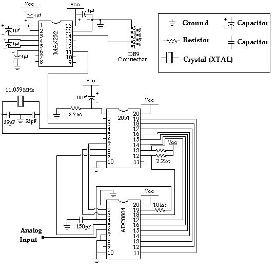

Please send me details about 12bit serial ADC for interfacing with 8051.
It should be cheap cause it is for hobby kit so you know it.

Burr Brown (TI) is a major manufacturer of ADC’s DAC’s. Check them out.
One of the easiest IC’s for experimentation is the old Tried N’ True ADC0804. And, it’s cheap! :D
(PS** Time to ditch the old 8051 and start PIC’n / ADC’s built in :wink: )

The ADC0804 is a nice part, but has a parallel interface. One thing you didn't mention was the speed you wanted to run the A/D conversions at.
If your application can make do with fairly slow conversions, here are two inexpensive designs from EDN that make use of a micro's hardware timer to help make the conversions.
https://www.e-insite.net/ednmag/contents/images/122001di.pdf
https://www.e-insite.net/ednmag/archives/1994/060994/12di9.htm
The first is a single-slope design, the second uses a dual-slope approach and provides good accuracy for such a simple circuit. Both circuits burden the micro with more work than a self-contained ADC, but keep your costs down.
If you want a complete single-chip 12-bit ADC, you might try Microchip's MPC3221, a very low power A/D with an I2C interface. It's available from Digi-Key for ~ $2.
