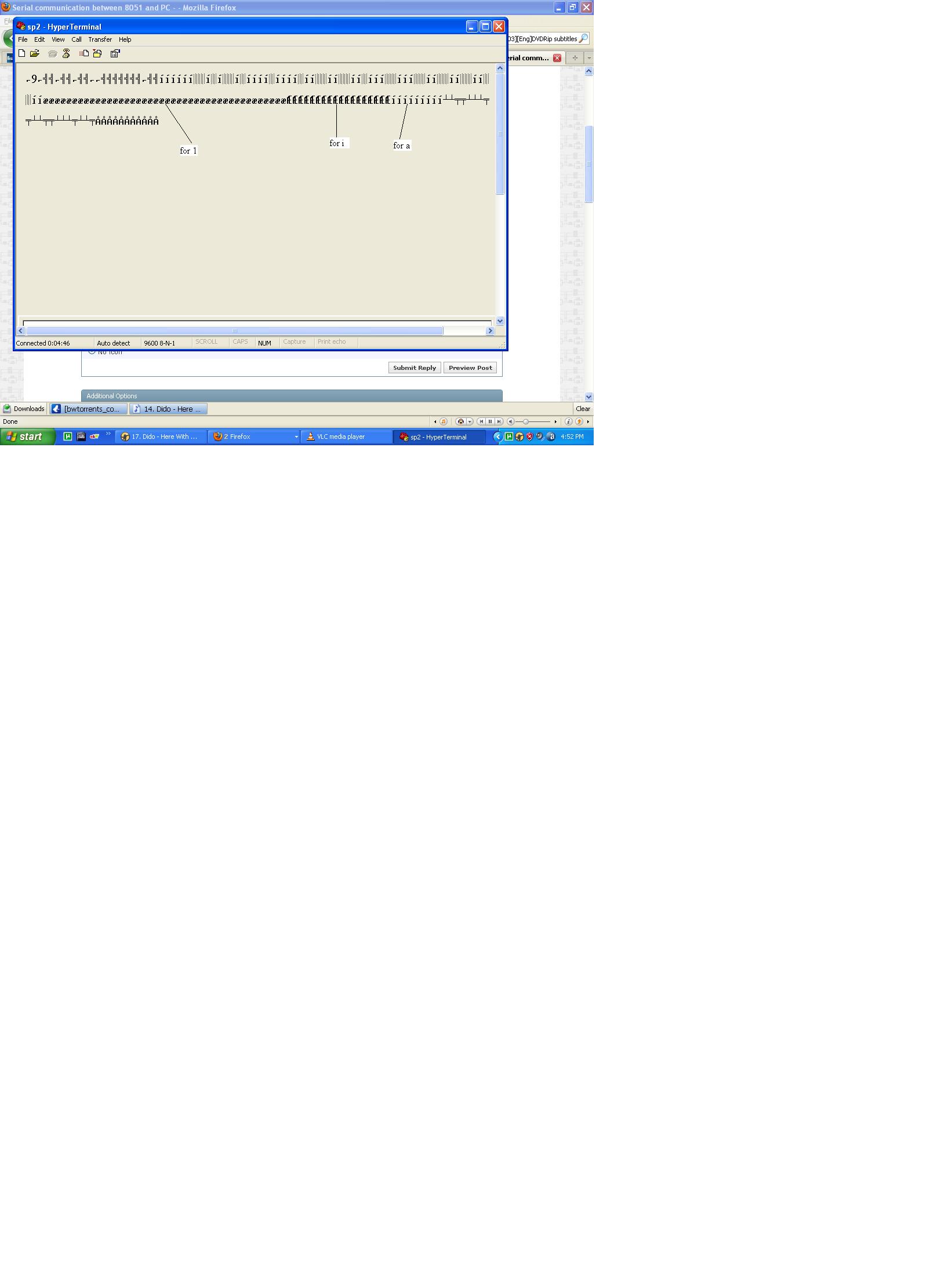

Thnx......now i am getting some arbitrary characters on hyper terminal screen. even if i send a binary value i get those same chars.
Please help me wid this prob.......

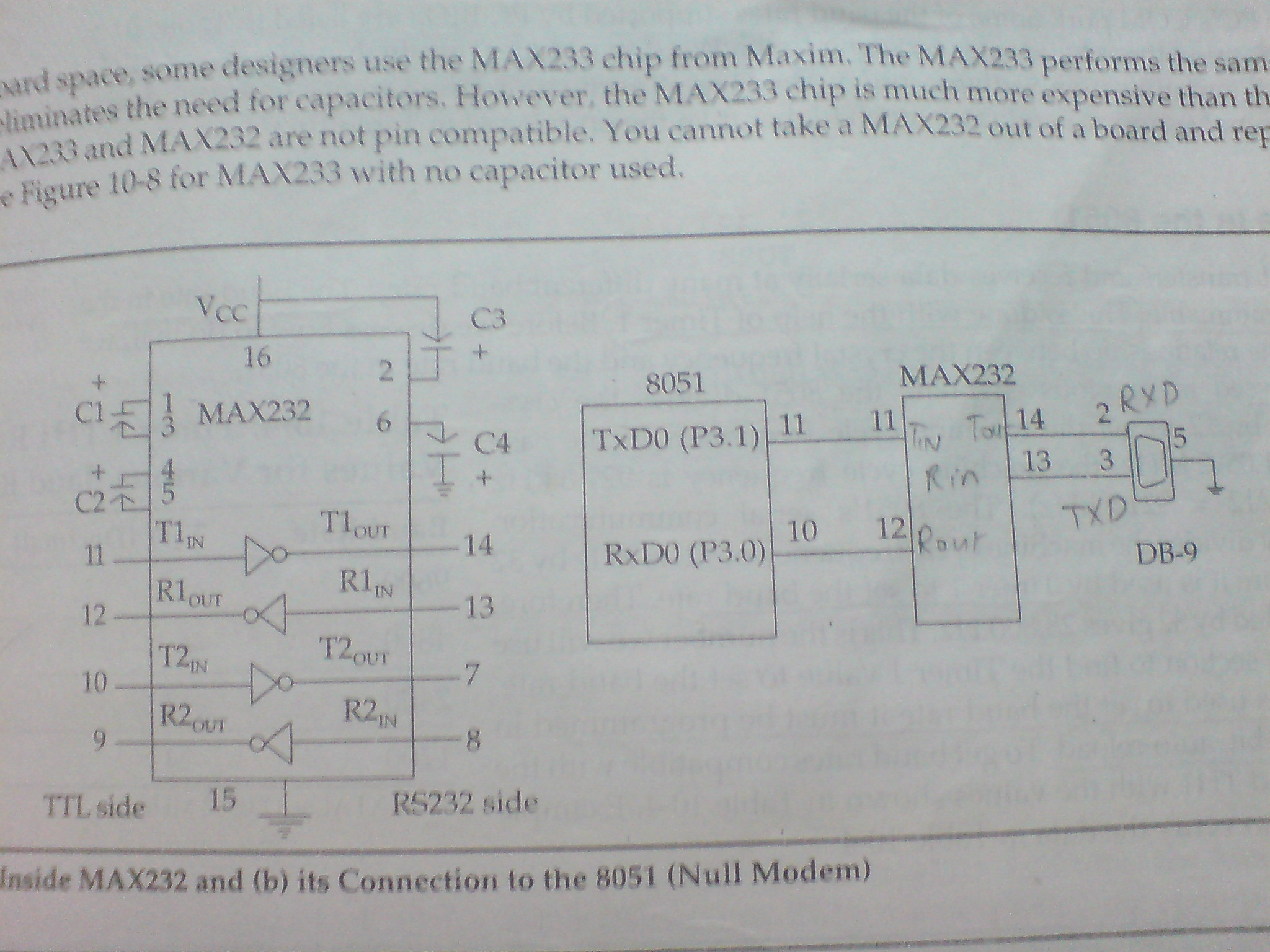

Circuit and snaps
The Max 232 chip is H1N232CPZ. uc is AT89s52. The hyperterminal screen shot is also attached. the code is:

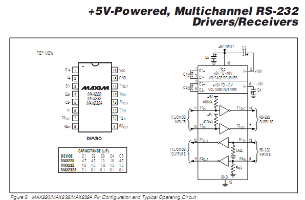

The text describes a MAX233 which does not require external capacitors, IF you are using a MAX232 you must add the 4 capacitors.

thanks all for your replies.....i got the thingz correct now.....i was using a 12MHz crystal and assuming it same as a 11.0592MHz one.......silly!
