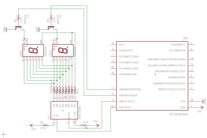

wow that bread board is over complex Why so many IC? Im sure you can do it all with 1 74HC164 and the Pic itself. Im sure with that kinda setup you can do 2 7 segs no problem.
Why use a decoder? You can do software decoding and then send it to the shift register. You can control the individual digits via transistors.
Ill make you a nice schematic so you can see how i would set it up.
The 74HC164 is an 8bit shift register, two 7segments is 14 control lines if you're running them right off the shift register so you'd need 2, or you'd have to multiplex it. If the shift register isn't a latching register multiplexing the 7 segments with it is going to create lots of nasty flicker so much I don't think it'd be usable.

The 74HC164 can run at speed up to 175MHz so i doubt a flicker will occur. Thats way faster than a pic can set a pin anyway. You can write to it as fast as a pic can write.
I just noticed its not a latch type tho. But thats always something obtainable :D

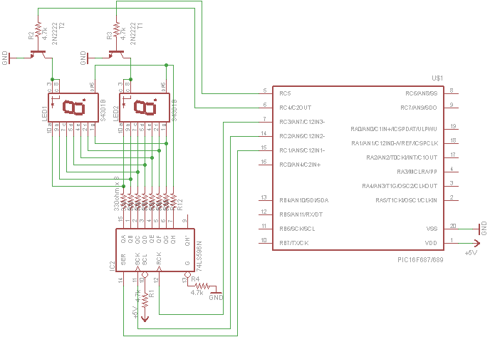

Here is a schematic using the 74xx595.
Warning i chose to pullup SCLR/SCL to save a data pin on pic. Doing this will not allow you to do a 1 time clear on the register. But you can still just shift in all 0's and do a software clear.
G is pulled down because all of the work you are doing will require it low anyway.
If you have Eagle i also included the schematic file so you can see it better.

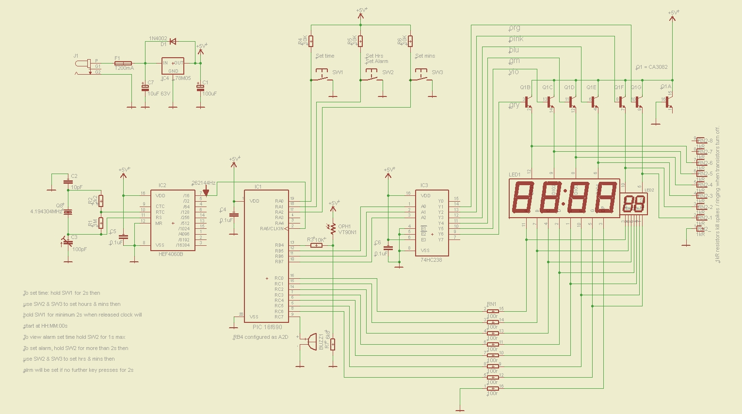

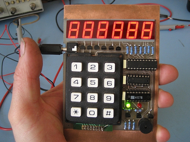

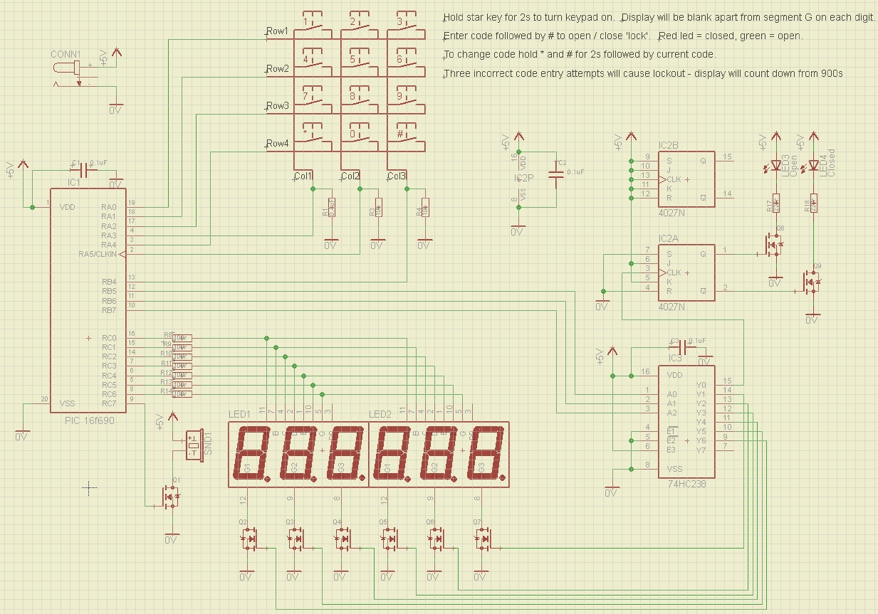

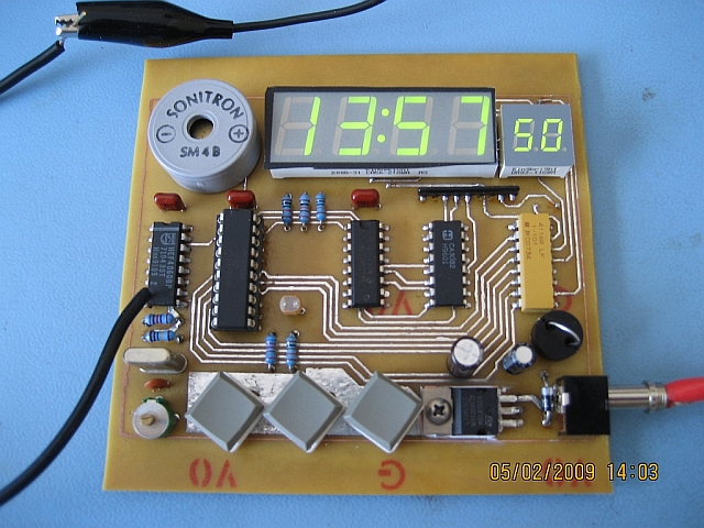

On my previous two projects I've driven the displays with parallel data, ccts / pics attached.

Nice looking stuff dude. You cant be that much of a noob to do that. Good job.

I don't see why you "need" to use the latch? I use 595's because I bought hundreds as surplus, but I never use the latch for driving displays. Just clock the data in, that takes a couple microseconds then hold the data for the multiplex period. You wont see any flickering from the couple uS clocking the data in!
You only need 2 PIC pins, for data/clk.
