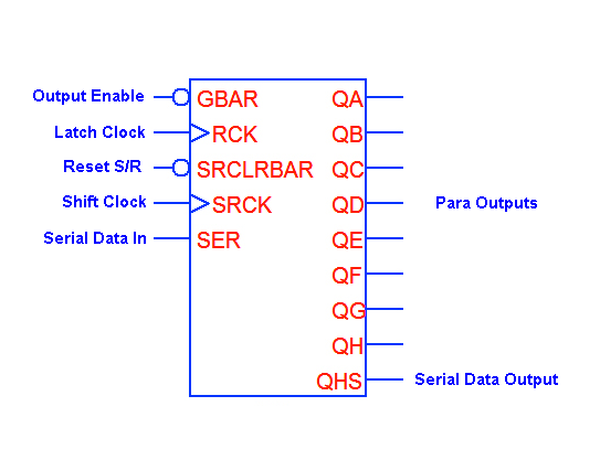

I have some questions about this register, it is a 74HC595, but I don't understand the name for each pin. Can anyone explain that for me?
What mean by RCK, SRCK, SRCLRBAR, GBAR and QHS?

Look at this image.
Where did you get that diagram.?:)

Thanks for the details, I got that diagram in micro cap. By the way, what is the latch and shift clocks? and also what is the purpose to use them? Can I fit in both with the same clock pulse? So in order to keep the circuit working, both GBAR and SRCLRBAR must be remained as logic "1" ? If I intend to make a 16 bits SIPO circuit, is that I need to fit QHS to the SER input in the next 74HC595?
Get the datasheet for the 74HC595 from Datasheet Archive - Free Datasheet Search Engine - PDF Datasheets - Data Sheet - Datasheet - Application Note - Free Texas Instruments Samples
Anytime you start working on a new device, get the datasheet and study it.
Understanding the datasheet will save you hours of grief.:rolleyes:
BTW: the 'BAR' part of the 'label' just means that the signal is active LOW.
Usually written so, /SRCLR , /G or with a bar over the label.
