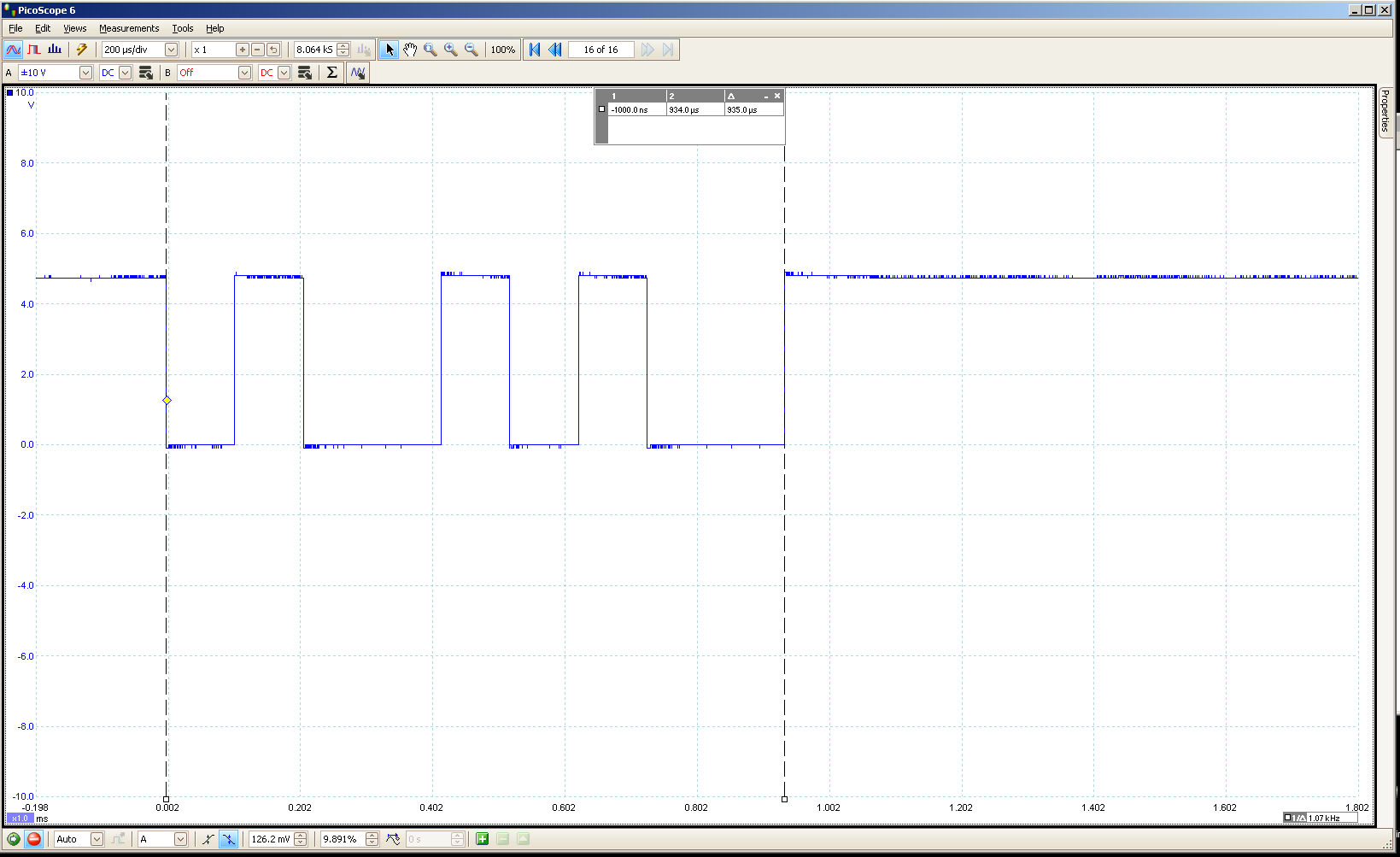

btw here's the scope of the byte ...
I have one idea .. maybe the imbecile cannot get "only one byte" I'll change the "sender" to send 2 bytes in a row instead of only one .. maybe that will help ...
