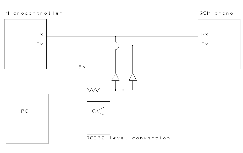

The first thing is that there may be local echo on the T630. The echo back from the T630 may be confusing your code.
You can turn off local echo (ATE0 - that is ATE<zero> not ATE<O as in orange>) then what you need to do is use hyperteminal to monitor what is being sent by the code and replied by the T630. The circuit attatched shows what you need.
With that, signals going in either direction will pull down through the diodes. That is converted to RS232 levels, and monitored by the PC, which runs hyperterminal. That should let you see what is going wrong.
